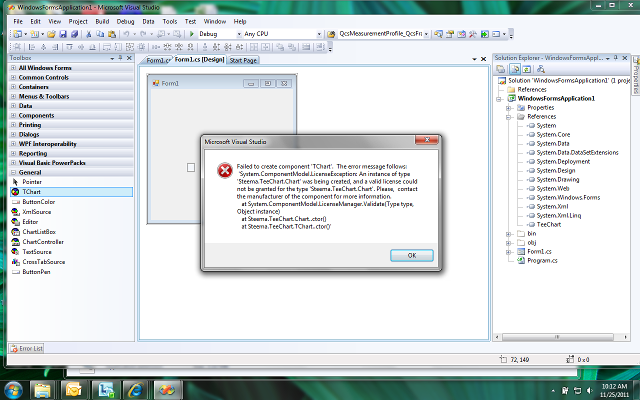

I am not able to use new dll provided by you. It's giving License error when I try to drag and drop TeeChart control to windows form. I have attached screenshot of this error.
Please let me know the resolution.

I tried using TeeRegV3 utility downloaded from client area to solve licenese error but this gives error "Error creating System registry entry".

Hello vishwa,
Please, take a look in this link, where you find some options to try to solve your problem with your licenses. If after doing all of recommendations there are in the thread, you don't achieve solve your problem, please let me know.

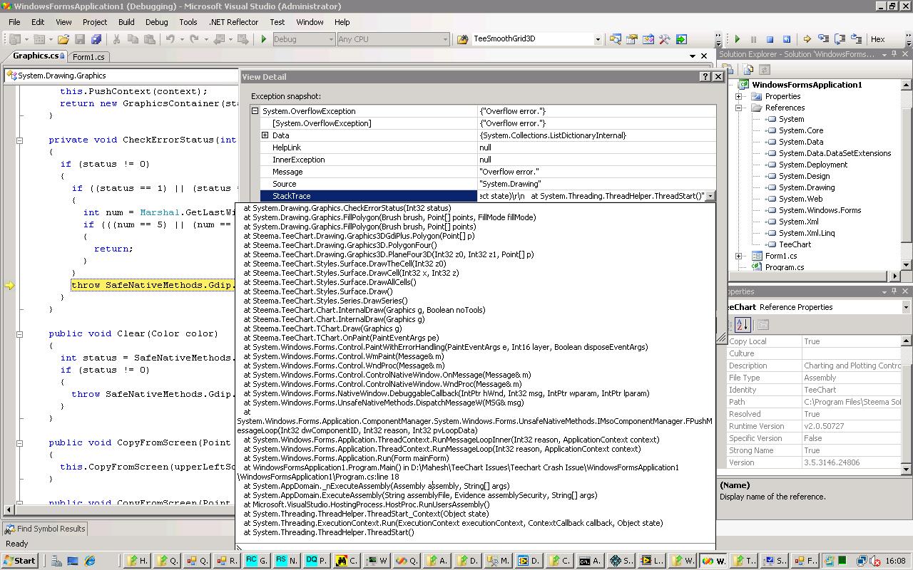

Now I'm able to build sample application with TeeChart dll version [3.5.3700.30575] but unfortunatly this version of dll also giving error "System.OverflowException: Overflow error". with following Stack Trace:
at System.Drawing.Graphics.CheckErrorStatus(Int32 status)
at System.Drawing.Graphics.FillPolygon(Brush brush, Point[] points, FillMode fillMode)
at System.Drawing.Graphics.FillPolygon(Brush brush, Point[] points)
at Steema.TeeChart.Drawing.Graphics3DGdiPlus.Polygon(Point[] p)
at Steema.TeeChart.Drawing.Graphics3D.PolygonFour()
at Steema.TeeChart.Drawing.Graphics3D.PlaneFour3D(Int32 z0, Int32 z1, Point[] p)
at Steema.TeeChart.Styles.Surface.DrawTheCell(Int32 z0)
at Steema.TeeChart.Styles.Surface.DrawCell(Int32 x, Int32 z)
at Steema.TeeChart.Styles.Surface.DrawAllCells()
at Steema.TeeChart.Styles.Surface.Draw()
at Steema.TeeChart.Styles.Series.DrawSeries()
at Steema.TeeChart.Chart.InternalDraw(Graphics g, Boolean noTools)
at Steema.TeeChart.Chart.InternalDraw(Graphics g)
at Steema.TeeChart.TChart.Draw(Graphics g)
at Steema.TeeChart.TChart.OnPaint(PaintEventArgs pe)
at System.Windows.Forms.Control.PaintWithErrorHandling(PaintEventArgs e, Int16 layer, Boolean disposeEventArgs)
at System.Windows.Forms.Control.WmPaint(Message& m)
at System.Windows.Forms.Control.WndProc(Message& m)
at System.Windows.Forms.Control.ControlNativeWindow.OnMessage(Message& m)
at System.Windows.Forms.Control.ControlNativeWindow.WndProc(Message& m)
at System.Windows.Forms.NativeWindow.DebuggableCallback(IntPtr hWnd, Int32 msg, IntPtr wparam, IntPtr lparam)
at System.Windows.Forms.UnsafeNativeMethods.DispatchMessageW(MSG& msg)
at System.Windows.Forms.Application.ComponentManager.System.Windows.Forms.UnsafeNativeMethods.IMsoComponentManager.FPushMessageLoop(Int32 dwComponentID, Int32 reason, Int32 pvLoopData)
at System.Windows.Forms.Application.ThreadContext.RunMessageLoopInner(Int32 reason, ApplicationContext context)
at System.Windows.Forms.Application.ThreadContext.RunMessageLoop(Int32 reason, ApplicationContext context)
at System.Windows.Forms.Application.Run(Form mainForm)
at WindowsFormsApplication1.Program.Main() in C:\Users\Qcsadmin\Desktop\Teechart Crash Issue\WindowsFormsApplication1\WindowsFormsApplication1\Program.cs:line 18
Please let me know the possible solution.

Hi Sandra,
I have uploaded TeeChart dll version[3.5.3146.24806] to the specified location. This is the same version used in our project and in sample application.
I have already tried TeeChart dll cersion [3.5.3700.30575 ] which you suggested , in that also application got crashed.
Regarding easy reproducability of issue please try with different limits like max 10 min -10 or max 5 min 0 such a way that data should be out of range.
For me also sometimes it takes time to crash [but it crash definitly] and sometime it crashes within few seconds. I hope changing limits to any other out of range limits will help reproducing the issue easily.
I have attached TeeChart-Crash bitmap with Stack trace for you easy reference.
- TeeChart-Crash
- TeeChart-Crash.jpg (255.3 KiB) Viewed 29427 times
