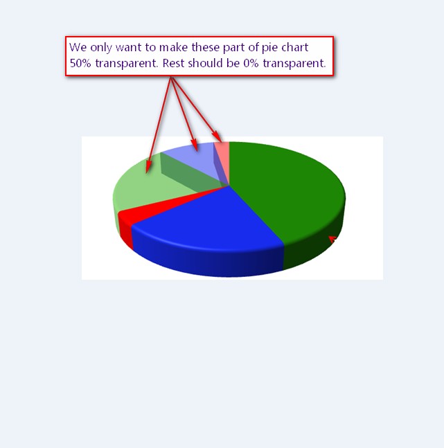

We are working on a project which is being created in Silverlight. For this we are using Tee-Chart for .NET 2010 Silverlight version. In this project there is one chart which contains a pie chart. In this pie we need some Slices with some transparency (say 50) and some with no transparency. Is there any possible way to do this task?
We are uploading an image in which there is a pie chart. In this chart there are 6 Slices. We need only Slice 1, Slice 2 and Slice 3 should be 50% transparent and rest will be 0% transparent.
Please suggest.

Sorry for the delay. I am afraid it isn't possible at the moment. I have added it in wish-list report with number[TF02015936] to be consider its inclusion for next maintenance releases of TeeChart.Net.

If you want, for the moment, you can try to implement your Custom Series where you can change the transparency of your Slices. You can find an example how you can make your custom Series here: http://www.teechart.net/support/viewtop ... gle#p25371
