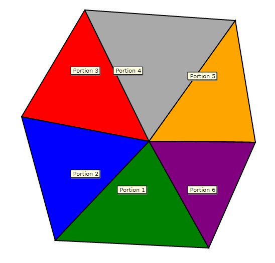

I have made a simple code where I can not reproduce your problem with MarkTips:
  public MainPage()
            Steema.TeeChart.Silverlight.Styles.Map map = new Steema.TeeChart.Silverlight.Styles.Map(tChart1.Chart);
            map.FillSampleValues();
            Steema.TeeChart.Silverlight.Tools.MarksTip marktip = new Steema.TeeChart.Silverlight.Tools.MarksTip(tChart1.Chart);
Previous code is made with last version of TeeChart.Net 2011. Can you check, if previous code works as you expected? If in previous code doesn't appears your problem please send us a simple example, so we can reproduce your problem exactly here.
