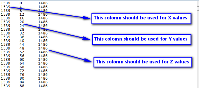

We are facing some problem while implementing ColorGrid in our project. We are putting our data which is in a text file in a format as shown in following figure.
We are putting this data into color grid but we are getting some exception, which we are unable to resolve as we could not find the reason why it is coming. We are attaching sample project by which you can understand what we are trying to do. Is there some data related issue or any thing else?
Please help us. Thanks in Advance.
Thanks & Regards
Planoresearch

Re: Want to know the series type for my requirement.
Post by Sandra » Tue Jan 03, 2012 9:09 am
Hello
Sorry for the delay. I can reproduce your problem using last version of TeeChart.Net and we have added request in bug list report with number[TF02015988]. We will try to fix it for next maintenance release of TeeChart.Net. On the other hand, if you want you can change the property IrreguralrGrid=false. I think is not a optimal solution for you, because some values don't appear in your grid, so in your case is necessary use IrregularGrid=true for the reasons explain in this link, but it allow you work with your project at the moment.
