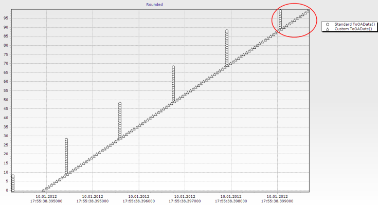

We have some customers who have some data with a resolution of one microsecond, and we d'like to create diagrams for them.
But there, the problems started: When we use the Series.Add(DateTime, double) method, the microseconds are rounded to the next millisecond. There would be the workaround to make my own ToOADate() method, which I did, only to find two new problems. The first one is that if I have steps of exactly one microsecond, the spaces between the points are not equally distributed. The second problem is the labels: I explicitly set them to display microseconds ("ffffff"), but it still only prints milliseconds, everything smaller is always zero.
I made a small sample, so you can reproduce these issues easily. (I used the TeeChart version 4.1.2012.01032, .Net 3.5).

- Comparison between custom and standard ToOADate() method
- rounded.png (56.22 KiB) Viewed 21958 times

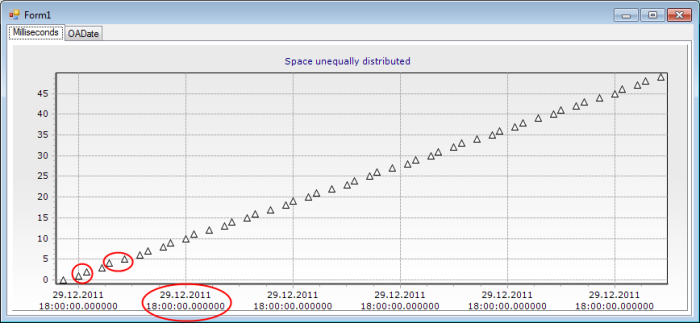

- unequally distributed space
- uneqallyDistributed.png (47.06 KiB) Viewed 21939 times

Sorry, I forgot answer this. We will work with it and we inform you asap.The first one is that if I have steps of exactly one microsecond, the spaces between the points are not equally distributed.
