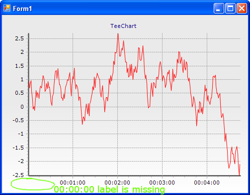

Re: Relative time axis + exotic calendar = divorce?
Hi Sandra
Thank you very much! Your solution seems to work well. If you could additionally tell me how to get the 00:00:00-Label back (see screenshot), it would even be perfect!
Manuel
Manuel
- MissingLabel.png (32.37 KiB) Viewed 11234 times
Hello Manuel,
The problem, basically, seems is that the first value of Series is 00:00:01 and when you add custom labels, value 00:00:00 doesn't appear.You can change the order of For where you populate the series as do next:
Initial For
Modified For:
Can you tell if it solve your problem?
Initial For
for (int i = 0; i < 285; i++)
oadate += oneSecondIncr;
value += rand.NextDouble() - 0.5;
tChart1[0].Add(oadate, value);
Hi Sandra
Yes, I already fixed that one as well but it did not helped. I also tried to set the axis scale manually. But that helped neither...
Any other idea?
Manuel
PS: when I change tChart1.Axes.Bottom.Minimum to 1.9999999999 then the label will show up. But that can hardly be the solution, right?
Any other idea?
Manuel
value += rand.NextDouble()-0.5;
tChart1.Axes.Bottom.Automatic = false;
tChart1.Axes.Bottom.Minimum = 2; //tChart1[0].XValues.Minimum;
tChart1.Axes.Bottom.Maximum = tChart1[0].XValues.Maximum;
Hello Manuel,
Yes, is a solution add, value Minimum of Bottom axis, manually to 2, since is double value you use to start to populate the Series and is the first value. In your case, if my previous suggestion doesn't help, this is the best solution. You need know, you can use SetMinMax() property to achieve a good scale for your in the axes. You can do something us next:
I inform you, I have made the test using value 2 and works fine for me, therefore you don't need use value 1.9999999999 to adjust your axis.
I hope will help.
tChart1[0].XValues.DateTime = true;
for (int i = 0; i < 10; i++)
tChart1.Axes.Bottom.Labels.DateTimeFormat = "s";
// tChart1.Axes.Bottom.Automatic = false;
tChart1.Axes.Bottom.SetMinMax(2, tChart1[0].XValues.Maximum);
I hope will help.
