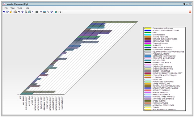

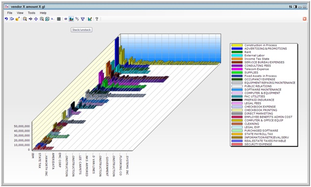

Hi:
We have an issue with the zdepth of 3d barcharts. Please reference the attachments called "good.jpg" and "bad.jpg". We note that when the "bad" graph is displayed, the tchart.axes.depth.Minimum = -0.5. When is "good" it is 100.
Strangely, when the graph is first rendered it looks "good", but after we refresh the form (me.refresh) it looks "bad".
Also, interesting is when we use the zdepth tool to drag we can "fix" the graph to make it look "good". And if we resize our form during runtime to make it taller, after refreshing, the graph can be made to look "good".
So I'm thinking that the automatic zdepth calculations are not working all of the time. Do you have any suggestions? Maybe there are some "minimum" values we can set some properties to, or alter the way that automatic depth calculations are made?
Matt
Matt
- bad.jpg (64.41 KiB) Viewed 14713 times
- good.jpg (74.63 KiB) Viewed 14706 times

I have more information:
When our form resizes, we resize the chart automatically. We noticed that if we make the form taller, the problem goes away and the chart is rendered correctly. Now, here is the strange part:
As we resize to different heights, the problem comes and goes, but not in a linear sequence. For example we might see the following pattern as we resize the form to be larger and larger:
1) initial render fails
2) make form taller and render works
3) make form EVEN taller and render fails
4) make form EVEN taller and render works again.

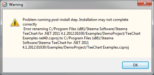

Finally, when I removed the 2010 reference from our project and added in the new 2011/3.5 reference, I received the following error from the debugger when our teechart form attempted to load:
{"Could not load file or assembly 'TeeChart, Version=4.1.2012.1032, Culture=neutral, PublicKeyToken=9c8126276c77bdb7' or one of its dependencies. An attempt was made to load a program with an incorrect format."}
I would say that the upgrade did not go well. Is there something else I need to do besides change the project reference to the dll?

Assembly Version: 4.0.0.0

Hi Sandra:
We are not making any progress on either front. So for now, let's focus on the zdepth issue. Also, since you can't seem to recreate the issue, and non of your suggestions have had any effect, let's try a different approach:
We have noticed that when we see a "bad" chart (flat, no-z), we can enable one of your built in tools and use the mouse to drag the zdepth around, and we can FIX the graph -- i.e make it look reasonable. The code to enable your tool looks like this:
CurrentTChart.Tag.DChart = True
So, when this built-in tool is active, specifically what chart properties is it changing? If we could know the answer to this question, we could work with those properties during the creation of the graph and hopefully get better results.
Does this sound reasonable?
Matt
Matt
