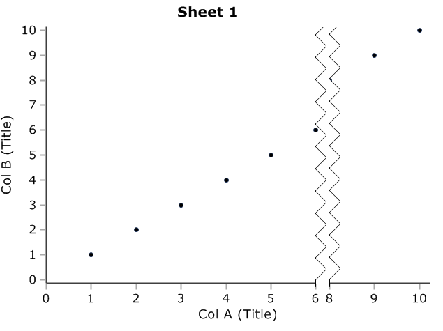

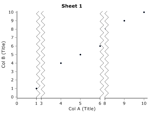

First, adding two breaks in a single axis causes the axis to be drawn through the first gap of the breaks. See attachements.

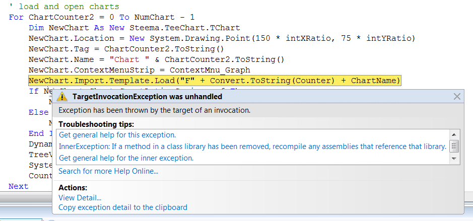

Secondly, I can not load charts as native format if the chart contains axis breaks. The following exception occur. The code works fine for charts not having any breaks.
Next code works fine for me in last version of TeeChartFor.Net 2012:

Can you please try if previous code works as you expect?
I have added it in wish-list with number [TF02016030] to be consider it inclusion in next maintenance releases of TeeChart.Net.

regarding the axis drawn through the gap, the your code does not resolve the problem, and is equavalent to the code I am using. You said you are using Teechart.Net V2012, but I checked the download page under Client access and the latest version available for download is TeeChartNET2011_4.1.2012.01030. So I am a little confused, and I would appreciate if you can confirm that you have used another version. If that is the case, how to download the latest version Teechart.net V2012?
Thanks for adding the issue with loading charts containing axis breaks on the wish list. But I think it should go on the bug list...it causes an exception, and makes the use of the binary format rather limited if I rely on axis breaks. I need also to use the binary format to save and load chart for later editing. So I would appreciate if this can be handled with a higher priority rather being on the wish list. I would appreciate the efforts.

loading charts with axis breaks from the binary format works now with the latest version Teechart2012 4.1.2012.2282 ...thank you very much.
