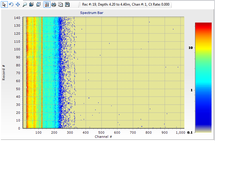

I see that someone has attempted to fix this problem (ie TF02016049), however I am yet to get it to work. To turn on logarithmic scaling on the legend palette I have attempted to do it both via the editor at design time, and run time, and programmatically.
Editor at run time - I can successfully check the logarithmic checkbox of a programmatically created LegendPalette and change the scale correctly. sbar.png (attached) is an example of what I'm trying to achieve.

- sbar.png (67.51 KiB) Viewed 10524 times
