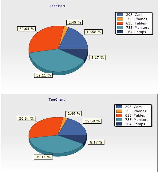

I am working with last version of TeeChartFor.Net (4.1.2012.02283), your code works fine for me and I get next results:
I recommend you download last maintenace release of TeeChartFor.Net you can find here and check again if your problem persist.
