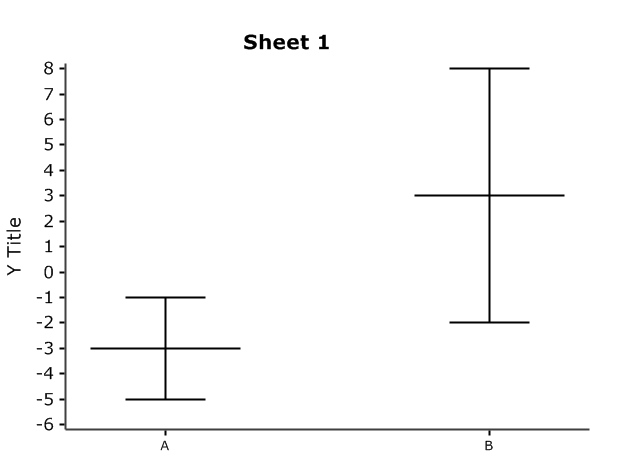

as an additional post to the most recent one, I had also problems with errorbars and negative values.
I created the attached chart as boxplot (invisible box and whisker, visible mean line) and added errorbars. The series "A" was created with Errorbar.Add(0, -3, 5, "A"), and the other series "B" with Errorbar.Add(1, 3, 5, "B"). As it can be seen the errorbar "A" has only a distance of 2 to the mean value, whereas errorbar "B" has the correct distance of 5. In other words, I would expect the errorbar "A" to start at -8 and end at +2. I am using the latest version Teechart.Net 4.1.2012.02283.

Hello Oli,
Next code works fine for me, so the distance of Error1 and Error 2 are correct fore me:

Can you tell as if previous code works fine for you?
