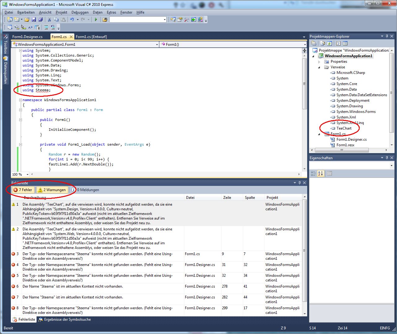

Re: Problems installing TChart
Hello Yeray,
You are right. With "execute as admin" the EvalExtender works. Thanks.
But now i have errors when compiling. See the attached image.
I added a reference to the project by "...\net40\x86\TeeChart.dll". Hope this is right. Without i cannot write "using steema;".
Hi Pat,
You are on a x64 OS, aren't you? If that's the case you should be referencing the x64 assemblies or explicitly build your projects as x86 applications.
Hello Pat,
Moreover, I suggest you check if your .Net Framework of your application, isn't Client Profile. To check it, you can follow next steps:
1.- Click on WindowsApplication with right button and select properties
2.- Go to Framework target and change Framework 4.0 Client Profile to Framework 4.0
3.- Run again your project.
On the other hand, If you want work with a Client Profile application you need do next:
1.- Go to references and remove TeeChart.dll
2.- Do click with right button and select Add References
3.- Go to the folder where you install TeeChartFor .Net 2012 and you select TeeChart.Client.dll
4.- Run again your project.
Hello at all
I changed framework target to "Framework 4.0" and it WORKS! Thank You Sandra.
The project reference for TChart.dll is the x86 one.
The elements for the toolbox are also from the x86 TChart folder.
Yes, i have a 64bit PC.
