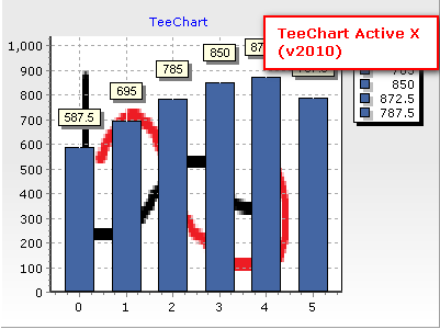

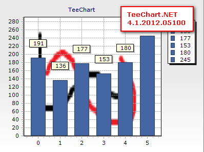

Here is another example just to make the issue really obvious. In this attachement:
background.bmp - very small (1x3 pixels) bitmap to appear on the back wall of a chart
Ax.bmp - desired output generated with TeeChart Active X v2010
NET.bmp - incorrect output generated with TeeChart.NET
Thanks!

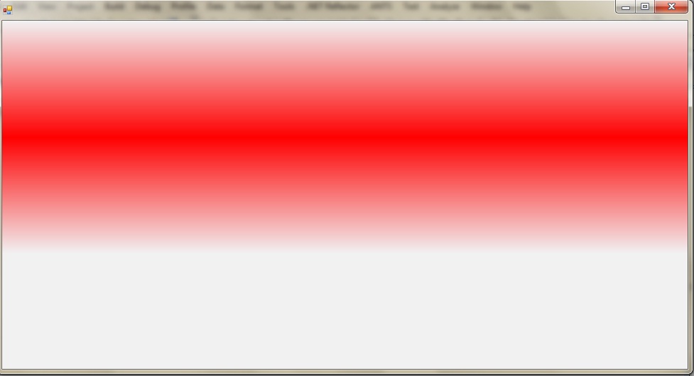

I have inform you that we have imported image directly in the Form and image we have loaded in background appears blurry (anti-aliased) and is the same result you get if you blow up the image with image Editor, therefore it is behavior produced for the way that .Net Framework has to treat the images bitmap when their ImageMode is streach. To check it I have made a simple code without TChart:
           BackgroundImage = Image.FromFile(@"C:\Users\Sandra\Downloads\TeeChartIssue\background.bmp");
           BackgroundImageLayout = ImageLayout.Stretch;
And I have gotten next results:
Would be very helpful gpt us. if you can send me the code you have used in Activex, because, we can try to find a solution for you using TeeChartFor.Net

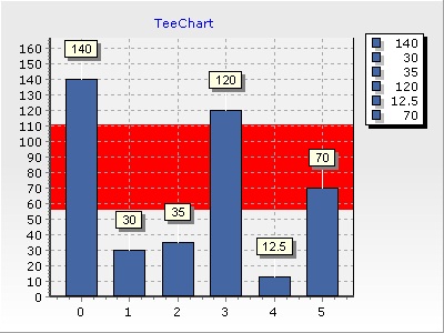

Would be very helpful if you can tell us with which version of ActiveX you made the code because using last version of ActiveX and your code I cannot get the same results as you and I get next result:
Thank,

Well, I used v2010 and v2011 - it works all the same. I think you're not getting the same result as I did because you're not doing the same thing. On your screen capture you have a control while what I'm talking about here is export to BMP. Could you please try my exact code?

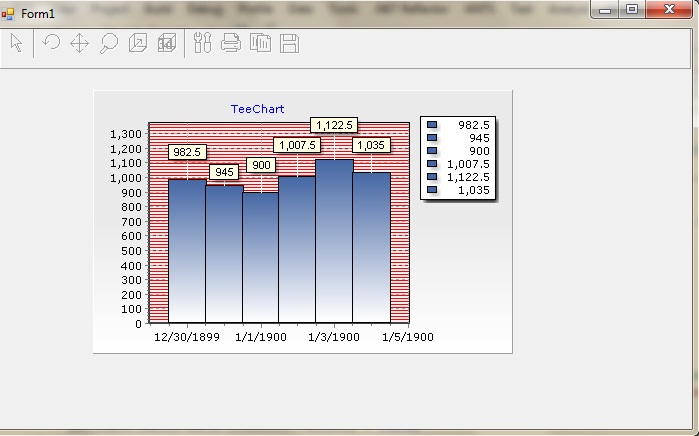

I was trying to use your idea in conjunction with Chart.Draw(Graphics g, Rectangle r) method and it almost worked. The image is now sharp but it is not aligned correctly:
The background is drawn in the top-left part of the chart. Compare to the output of Active X version:

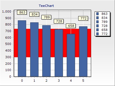

Which produces this image for me:
Does this fit your needs or do you needs?
