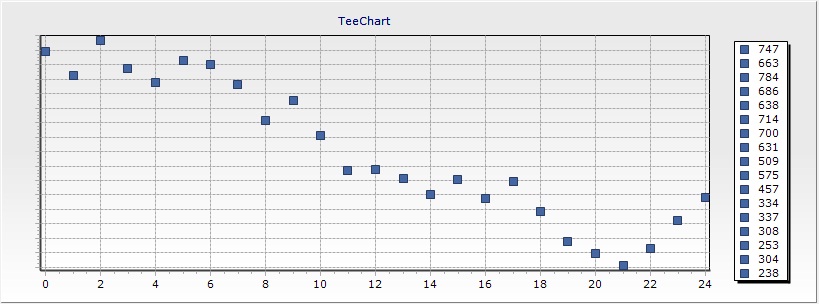

Ok. Can you attached a image where appears your problem because we can try to find a solution for you? So, using the code Narcís has suggested you, I don't see your problem here and I get next results that I consider correct:

I did made a mistake. I supplied string.empty instead of a space. This leaves the gridlines enabled but does consume the space needed for the labels. This space is too big for me. I need to be able to create a 2-3 pixels margin.
