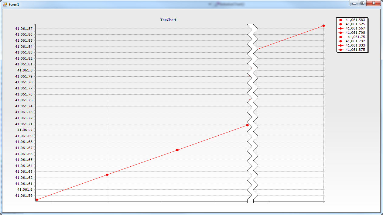

I found strange new problem with your solution.
If I use tChart1.Axes.Bottom.Labels.DateTimeFormat = "HH:mm"...all the bottom labels are disappeared from chart.
To reproduce the problem ,please use below code.

PLease see attached scrren shot of problem.
Can you please help me on this issue?
Namit Shah
Screen shot of Problem
Re: Axis Break tool with datetime in X axis
Post by Sandra » Tue Aug 07, 2012 10:41 am
Hello Namit,
After doing many test, I have added your problem in the bug list report with number[TF02016292] to investigate the problem and try to fix it to upcoming versions of TeeChartFor.Net.
