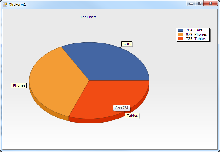

I am creating pie chart with marks tio tool,but I found a problem.
Marks tip display only first data only any where in graph. It not display correct data.
Please see the attached screenshot.
            Steema.TeeChart.Styles.Pie pie = new Steema.TeeChart.Styles.Pie();
            Steema.TeeChart.Tools.MarksTip markstip = new Steema.TeeChart.Tools.MarksTip();
            markstip.Style = Steema.TeeChart.Styles.MarksStyles.LabelValue;
            tChart1.Tools.Add(markstip);
            pie.FillSampleValues(3);
            tChart1.Series.Add(pie);
can you please help me? how I display correct data in markstip?
Namit Shah
you can see it display wrong markstip(i.e. cars 784) on tables.

Ok, I explain you. Always, I make first the test to find the problems using our source code and after I check it with TeeChart.dll of installer. In your case,I only have checked your problem using our source code and in it doesn't appear the problem, but I have realized that I hadn't made the test with TeeChart.dll, and when I have checked the problem with assembly, it appears. Therefore, yes I can reproduce your problem but it is solved for next maintenace release. I recommend you to be aware at this forum, our RSS news feed, twitter and facebook accounts for new release announcements and what's implemented on them.
