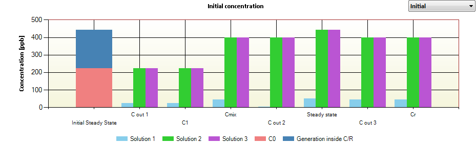

I facing problem to create a bar chart with side bar and stacked bar together. Could you guide me how to do that?
My teechart .Net version is 4.1.2012.1033
Here is the sample chart
