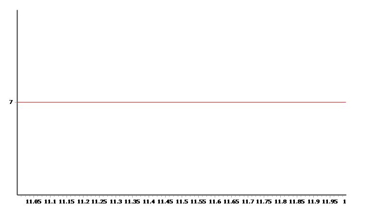

Have a line graph with 2 plots, both the same values 7 and one for Month 11 & one for Month 12 (so 11 & 12 on scale), the scale is adding numbers ie 11.1 11.2 11.3 I simply want 11 and 12 appearing, see sample, I have tried the following
WebChart1.Chart.Axes.Bottom.Labels.Style = Steema.TeeChart.AxisLabelStyle.Value; //Fix value style
WebChart1.Chart.Axes.Bottom.Automatic = false;
WebChart1.Chart.Axes.Bottom.Minimum = 11;
WebChart1.Chart.Axes.Bottom.Maximum = 12;
WebChart1.Chart.Axes.Bottom.Increment = 0;

Hello mikethelad,
I recomend you do somenthing as next code to achieve as you want:
        Steema.TeeChart.Styles.Line line = new Line(tChart1.Chart);
        line.Add(11, 7);
        line.Add(12, 7);
        line.Add(0, 7);
        tChart1.Axes.Bottom.Labels.Style = AxisLabelStyle.PointValue;
Can you tell us if previous code works as you want?

Working now, thanks
