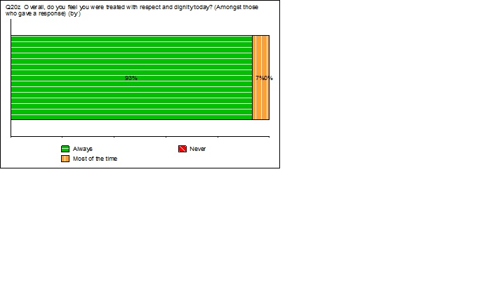

Trying to achive a graph as per sample, I have tried an area graph, but I only have 1 value for each response, so all I get is all in the left hand column, I need to fill the area 100%, so was thinking the area graph is what is needed
- area.jpg (36.07 KiB) Viewed 6365 times

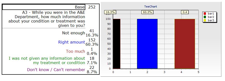

Thanks, your demo worked fine apart from can't see how the invert works as this did not work, I have added my 3 of my values to the data, but is not right, see attached
- graph.JPG (61.58 KiB) Viewed 6268 times

Hello mikethelad,
I have made a simple code to adapt the bars at your values:
Can you tell us if previous code help you to achieve as you want? As you see you need modify the Xvalue to adapt your data.
CustomBarSize bar1, bar2, bar3;
bar1 = new CustomBarSize(tChart1.Chart);
bar2 = new CustomBarSize(tChart1.Chart);
bar3 = new CustomBarSize(tChart1.Chart);
bar1.Add(1, 100, "16.3%", Color.Black);
bar2.Add(2, 100, "60.3%", Color.Blue);
bar3.Add(3, 100, "0.4%", Color.Red);
bar1.SideMargins = false;
bar2.SideMargins = false;
bar3.SideMargins = false;
bar1.SizeValues[0] = 1.63;
bar2.SizeValues[0] = 6.3;
bar3.SizeValues[0] = 0.04;
bar1.XValues[0] = 0;
bar2.XValues[0] = 2;
bar3.XValues[0] = 5.1;
tChart1.Axes.Bottom.Labels.Style = AxisLabelStyle.Value;
tChart1.Axes.Bottom.SetMinMax(-2, 5.2);
tChart1.Axes.Bottom.Increment = 1;
tChart1.Axes.Bottom.MinimumOffset = 1;
tChart1.Axes.Bottom.MaximumOffset = 1;
