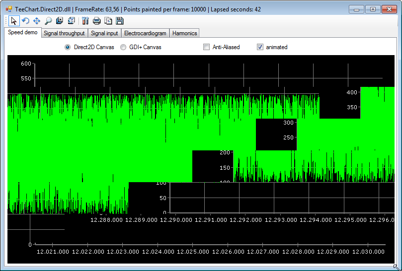

I have planned to use the TeeChart Direct2D to plot data @ 20Khz. While experimenting with the component I found that the display is scrambled for certain ratios of the display (see attached image).
You can reproduce the error running your Direct2DDemo and resize the Window. Any idee what the reason is and how to solve the problem?

I can not reproduce your problem here using last version of TeeChartFor.Net and Windows 7. Can you please, tell us which version of TeeChartFor.Net are you using? Moreover, can you tell us specifications of your machine and O.S, so we can try to reproduce it here?

The scrambling occures only for certain ratios of the plot.

Problem is solved:
I have updated the graphic card driver and the scrambling of the chart vanished.
