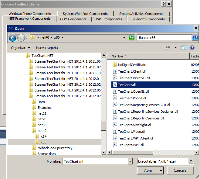

This should work. It does for me here:sunzhaoshan wrote:then I select the file TeeCahrt.dll at C:\Program Files (x86)\Steema Software\Steema TeeChart for .NET 2012 4.1.2012.07130\net40\x86, the same message appears.

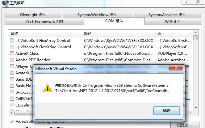

The wrong message is as following pic.
- the wrong message
- wrong.jpg (105.47 KiB) Viewed 9443 times

It might be that the installer or the files copied were corrupted. Could you please try downloading and installing the installer again? If the problem persists, could you please translate into English the text of the error message?
