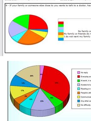

Is it possible to increase the tilt of the 3D Pie?

No, I meant the angle on the pie, see sample file, the top is what I am getting from Steema, the bottom one is what is required,

Sorry , I got confused. In your case you, first you must change Chart3D as do in next line of code:
    tChart1.Aspect.Chart3DPercent = 40;
If previous line of code doesn't solve your problem you can change the Orthogonal angle as do in next lines of code:
tChart1.Aspect.Orthogonal = true;
tChart1.Aspect.OrthoAngle = 30;

Have tried both of these ways and neither change the pie

Ok. Please check next code if works in your end?
 Steema.TeeChart.Chart tChart1;
    protected void Page_Load(object sender, EventArgs e)
        tChart1 = WebChart3.Chart;
    private Steema.TeeChart.Styles.Pie pie1;
        pie1 = new Pie(tChart1);
        //tChart1.Aspect.Orthogonal = true; //uncomment if you want work with Orthogonal property.
        //tChart1.Aspect.OrthoAngle = 30;//uncomment if you want works with a Orthogonal property and a determinate angle
        pie1.FillSampleValues();

Work out why and the Chart3DPercent now works thanks
