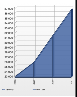

I am creating an area chart in an ios application with multiple area series.
I have set SeriesArea.Transparency = 40;
Due to this all area series appear in the same blue color:
Screen shot 2012-09-20 at 12.03.21 PM.png (49.97 KiB) Viewed 9671 times

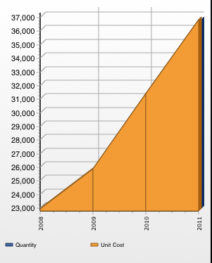

If i do not set the Transparency then it shows like :
Screen shot 2012-09-20 at 12.06.26 PM.png (41.73 KiB) Viewed 9674 times
So in the screenshot above the two areas are overlapping each other.
Please let me know how to show both areas with some transparency and different colors.

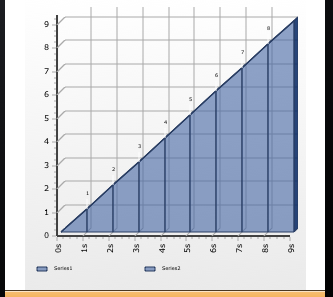

Screen shot 2012-09-24 at 10.26.58 AM.png (39.09 KiB) Viewed 9609 times
Re: Multiple area chart with different colors for each area
Post by Sandra » Mon Sep 24, 2012 1:59 pm
Hello incadea,
Your code helped us to detect your problem. Basically it is produced if you try to change values of transparency property before add points in series. I have added this issue in bug list report with number[TF02016355]. We will try to fix it to upcoming versions of TeeChartFor.Net. On the other hand, at the moment, to solve the problem you must change the values of transparency property after add points of series. You can do something as next code:
