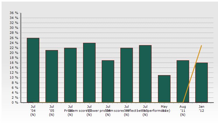

Bar Graph label wrapping
Post by mikethelad » Fri Oct 05, 2012 12:22 pm
On the sample bar graph, bars 3 and 7 have no labels, the labels are being added correctly,as if I shorten the text hey appear, it is trying to add Aug '10 (N) and Aug '11 (N)
I am guessing the sofware is thinking the will not fit, is there a way of making it wrap?

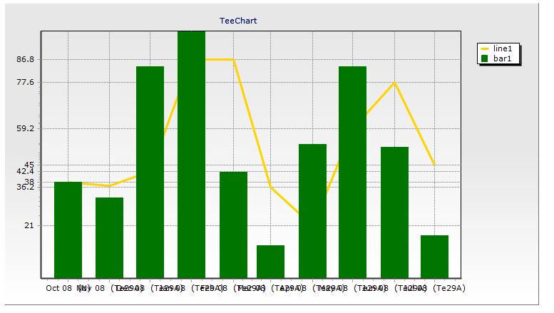

Post by Sandra » Fri Oct 05, 2012 3:54 pm
Hello mikethelad,
I have made a simple code with last version, and I can not reproduce this problem using the code:
    Steema.TeeChart.Styles.Line line;
    Steema.TeeChart.Styles.Bar bar1;
    Steema.TeeChart.Functions.ExpAverage average1;
    DateTime dt = DateTime.Now;
        //tChart1.Dock = DockStyle.Fill;
        line = new Steema.TeeChart.Styles.Line(tChart1);
        bar1 = new Steema.TeeChart.Styles.Bar(tChart1);
        average1 = new Steema.TeeChart.Functions.ExpAverage();
        bar1.XValues.DateTime = true;
        bar1.Marks.Visible = false;
        Random rnd = new Random();
        for (int i = 0; i < 10; i++)
            bar1.Add(dt, rnd.Next(100));
            dt = dt.AddMonths(1);
        bar1.Color = Color.Green;
        bar1.Pen.Color = Color.Green;
        line.DataSource = bar1;
        line.Function = average1;
        line.Color = Color.Gold;
        line.LinePen.Width = 3;
        tChart1.Axes.Bottom.Labels.DateTimeFormat = "MMM-dd";
        tChart1.Axes.Left.Labels.Style = Steema.TeeChart.AxisLabelStyle.PointValue;
        for (int i = 0; i < bar1.Count; i++)
            if (i == 0)
                tChart1.Axes.Bottom.Labels.Items.Add(bar1.XValues[i], DateTime.FromOADate(bar1.XValues[i]).ToString("MMM" + "dd" + "(N)"));
                tChart1.Axes.Bottom.Labels.Items.Add(bar1.XValues[i], DateTime.FromOADate(bar1.XValues[i]).ToString("MMM" + "dd"));
Can you please, modify my code because we can reproduce your problem here?

I copied your code into a test program, this did not wrap, if I had extra text next to dates which I need sometimes, again it does not wrap but overlaps, I need to wrap to another line below

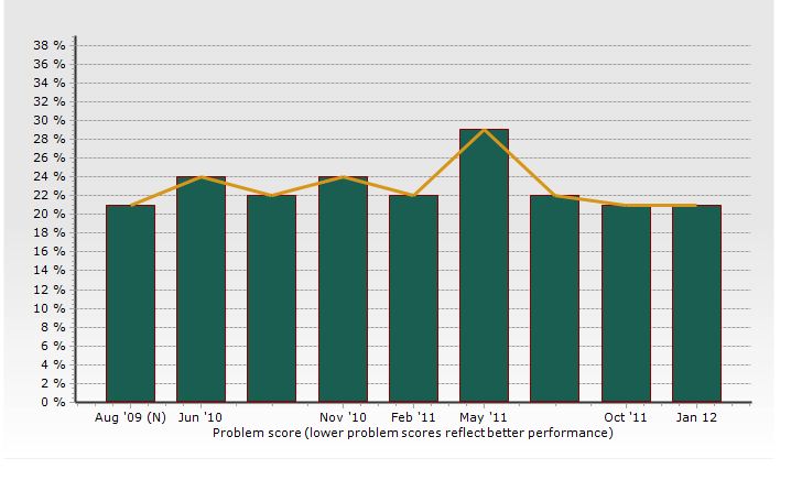

Getting there thanks, see new sample, how can I move the
WebChart1.Chart.Axes.Bottom.Title.Text = "Problem score (lower problem scores reflect better performance)";
Further down
Re: Bar Graph label wrapping
Post by Sandra » Wed Oct 10, 2012 3:25 pm
Hello mikethelad,
I am afraid the titles of axes can not move independently. For this reason, I suggest you draw directly in the canvas the text of titles of axes as do in next sample of code:
