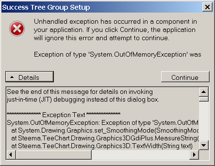

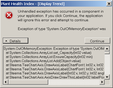

In Our Application,on single module, we have 20 Charts,Each Chart has 2-3 FastLine Series and each Series is drawn with 600 points and we are updating series data every 1 sec.
After we keep running our application till 8-10 days we arte getting out of memory Exception.(Snap is Attached.) When we start our application it takes 150-180 MB memory.But after 8-10 days it reached up to 1500 MB.
