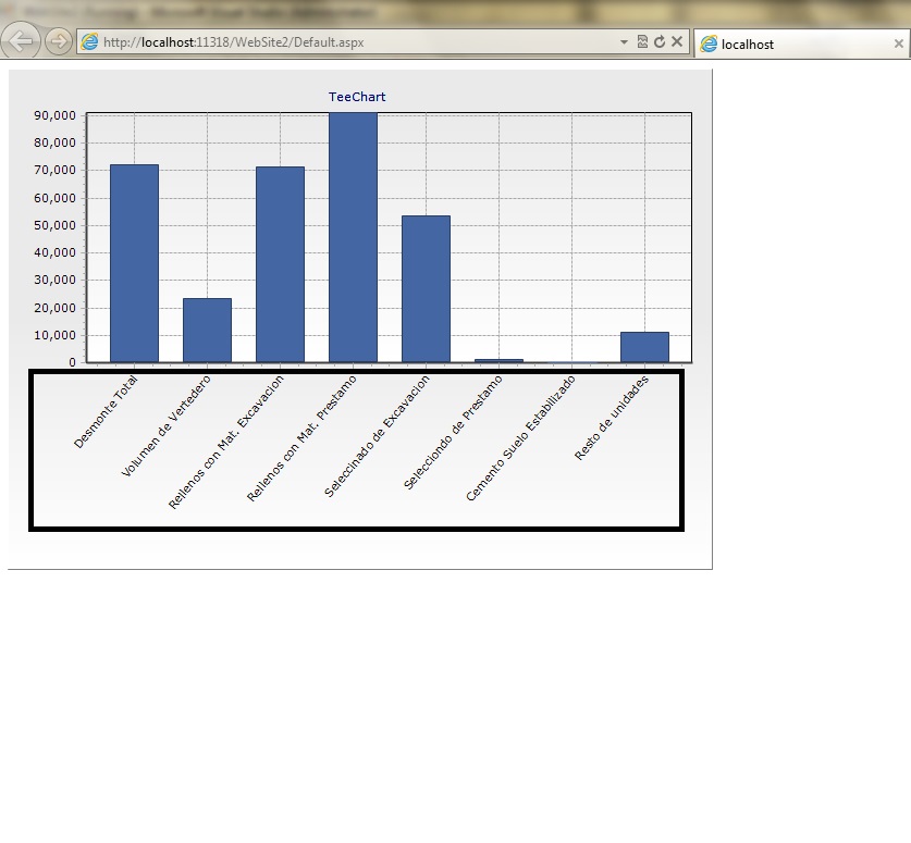

I have achieved next result in the browser:

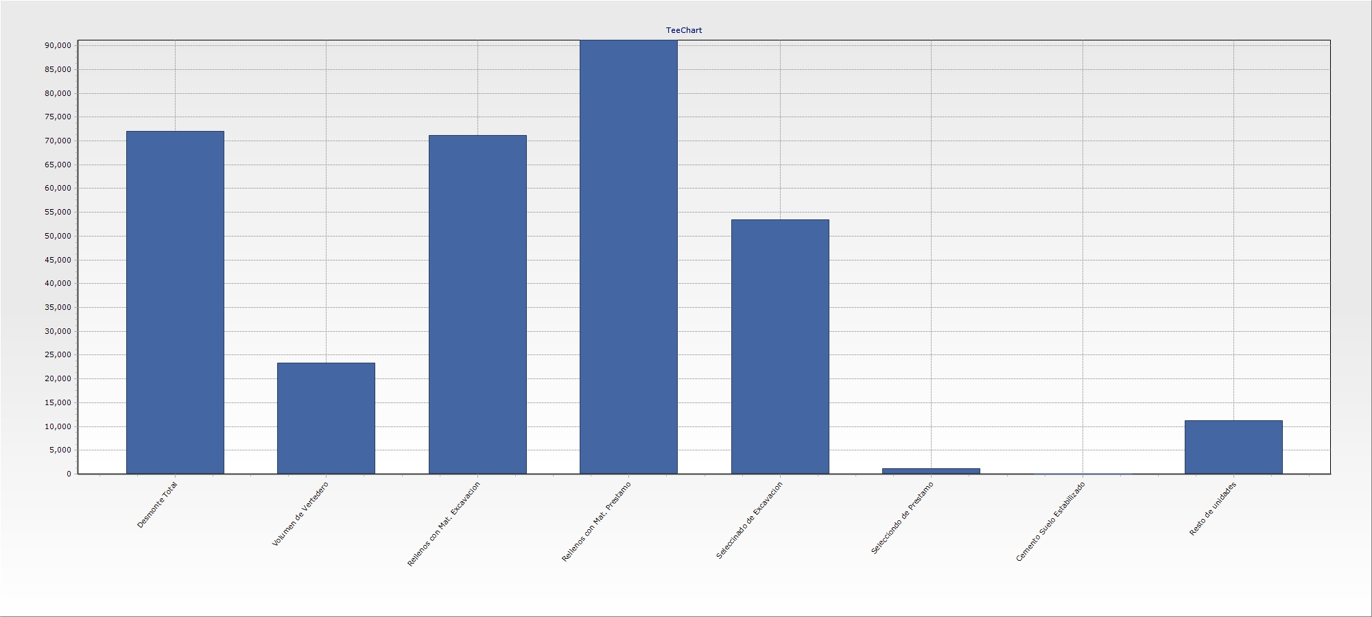

I have gotten next image using your indications to export the chart:
I consider the results are correct. For this reason,I would be very grateful if you can indicate us, if the problem appears in my attached images. If it doesn't appear, please try to modify the code, so we can reproduce your problem here. On the other hand, could you please tell us which version of TeeChart are you using in this moment?

Re: Saving chart with itextsharp
Post by Sandra » Thu May 30, 2013 9:27 am
Hello Fulcrum,
I have attached my project where your problem doesn't appear using latest versions of TeeChartFor.Net (4.1.2012.01312). For this reason, we would be very grateful if you can check my attached project and inform us of results you get.
On the other hand, could you confirm us which version are you using?
WebSite7.zip
(5.98 KiB) Downloaded 497 times
Now I havee notice something in your code that i didnt do when I tried it
CODE: SELECT ALL
series1 = New Steema.TeeChart.Styles.Bar(TChart2.Chart)
when you define series1 you use TChart2, how do you define it. I defined it like the chart I was using and that could be my mistake.
Do I have to define a second chart?
Sorry, I have forgotten to remove this line of code, isn't necessary.

Post by Fulcrum » Thu May 30, 2013 12:17 pm
Hello Sandra and thank you, your projects Works fine and I have fixed the problema but when i tried in this one dont seem it solves anything.
labelstext1 = New String() {"Hormigon", "Acero Estructural", "Acero con Arma. Pasivas", "Acero en Pretensados"}
        Dim ch1 As Steema.TeeChart.Chart = WebChartTripleBarras1.Chart
        ch1.Series.RemoveAllSeries()
        ch1.Series.Add(New Steema.TeeChart.Styles.Bar())
        Dim SeriesBar1 As New Steema.TeeChart.Styles.Bar()
        SeriesBar1.Add(72049.789999999994, "Hormigon")
        SeriesBar1.Add(23371.139999999999, "Acero Estructural")
        SeriesBar1.Add(71177.119999999995, "Acero con Arma. Pasivas")
        SeriesBar1.Add(91177.119999999995, "Acero en Pretensados")
        SeriesBar1.Marks.Visible = False
        'ch1.Legend.Shadow.Visible = True
        ch1.Legend.Visible = False
        ch1.Series(0).ShowInLegend = False
        'ch1.Series(0).Color = Color.CornflowerBlue
        ch1.Walls.Back.Gradient.Visible = False
        ch1.Walls.Back.Color = Color.White
        ch1.Panel.Gradient.Visible = False
        ch1.Panel.Color = Color.White
        ch1.Axes.Bottom.Labels.Angle = 30
        SeriesBar1.Color = Color.Blue
        SeriesBar1.Gradient.StartColor = Color.RoyalBlue
        SeriesBar1.Gradient.MiddleColor = Color.DodgerBlue
        SeriesBar1.Gradient.EndColor = Color.DeepSkyBlue
        SeriesBar1.Gradient.UseMiddle = True
        SeriesBar1.Gradient.Visible = True
        SeriesBar1.BarStyle = Steema.TeeChart.Styles.BarStyles.RectGradient
        AddCustomLabelsBar1(SeriesBar1, labelstext1)
        ch1.Series.Add(SeriesBar1)
        'ch1.Panel.Bevel.Outer = Steema.TeeChart.Drawing.BevelStyles.None
        JpegBarras1.Quality = 100
        JpegBarras1.Width = 900 'm_PictureBox.Width
        JpegBarras1.Height = 700 'm_PictureBox.Height
        WebChartTripleBarras1.Chart.Export.Image.JPEG.Save("C:\ImagenInformeTripleBarras1Final.jpeg")
Could it be I miss something?
Post by Sandra » Thu May 30, 2013 3:02 pm
Hello Fulcrum,
I have modified a little your code and using it but my AddCustomLabels method, your code works in correct way:
       Private series1 As Steema.TeeChart.Styles.Bar
    Private labelstext As String()
    Private ch1 As Steema.TeeChart.Chart
    Private Sub InitializeChart()
        ch1 = WebChart1.Chart()
        labelstext = New String() {"Hormigon", "Acero Estructural", "Acero con Arma. Pasivas", "Acero en Pretensados"}
        Dim SeriesBar1 As New Steema.TeeChart.Styles.Bar(ch1)
        SeriesBar1.Add(72049.79, "Hormigon")
        SeriesBar1.Add(23371.14, "Acero Estructural")
        SeriesBar1.Add(71177.12, "Acero con Arma. Pasivas")
        SeriesBar1.Add(91177.12, "Acero en Pretensados")
        AddCustomLabels(SeriesBar1, labelstext)
        WebChart1.Chart.Export.Image.JPEG.Save("C:\ImagenInformeTripleBarras1Final.jpeg")
    End Sub
    Protected Sub AddCustomLabels(ByVal s As Steema.TeeChart.Styles.Series, ByVal arraylabels As String())
        ch1.Chart.Axes.Bottom.Labels.Items.Clear()
        For i As Integer = 0 To s.Count - 1
            ch1.Chart.Axes.Bottom.Labels.Items.Add(s.XValues(i), arraylabels(i))
        Next
    End Sub
I have made the test in VS2008 and latest version of TeeChartFor.Net. Do you use last version of TeeChartFor.Net?
