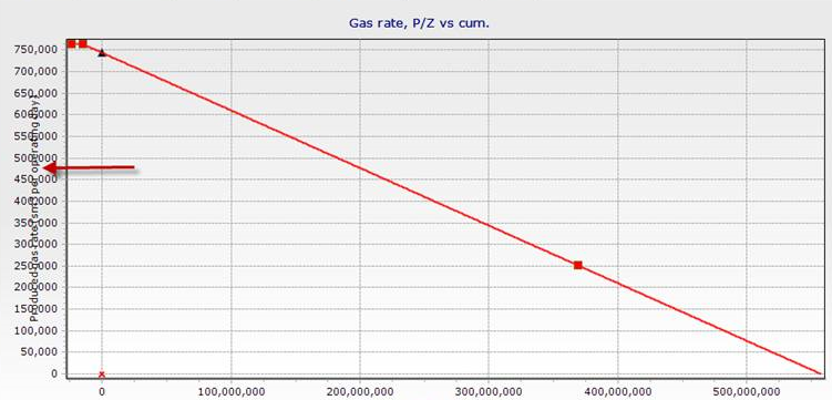

The attached image shows the y-axis title being overwritten by the y-axis labels. When this chart was first drawn, the max value on the y-axis was only 3-digits. But the user can interact with the chart changing the range up to 1,00,000. As this happens, the space reserved for the y-axis labels is not increased and the new labels overlap the y-axis title. Is there some setting that will cause the axis layout to dynamically recalculate as the range is changed? If not, is there a method I can call to ask TeeChart to update the layout reflecting the new range?

No, I'm afraid this doesn't help. In my graph, Panel.MarginLeft is always just 3.0 and setting it to a larger value just gives me wasted space along the left edge.
Fooling around with the many properties on the chart (thanks for those, btw!), I think I found my answer. I believe all that is necessary is:
    tChart1.Axes.Left.FixedLabelSize = false;
