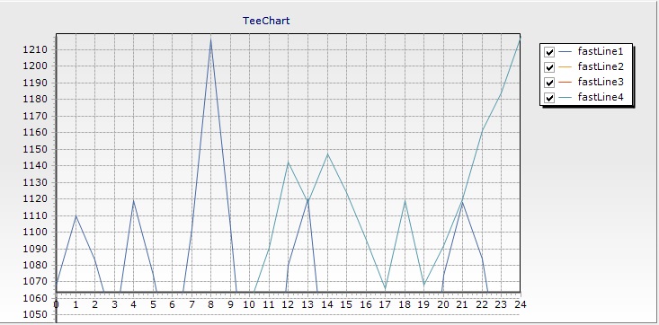

I can get next image:

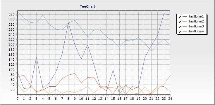

If you change PositionUnits.Pixels to PositionUnits.Percent I can get next image:
You can see differences in the both images, when you work with percent or pixels, therefore the StartPosition and EndPostion not only works with percent. If your problem persist, would be very grateful if you can explain us exactly where the problem is produced and why do you consider the properties doesn't works by pixels because we can try to help you?

As for problem 3, we did see that exact issue (as seen in the image) where the axis overruns the bottom edge of the chart. We have resolved the issue by using 100 as a percentage instead of a height in pixels regardless of the units the chart is configured in.
