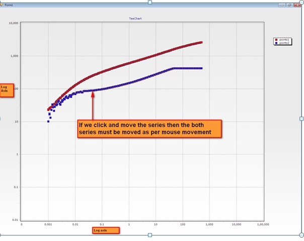

I am using tee chart Point series in Window form application, here I am facing one problem related to moving point series on my chart whose Left and Right Axis is Logarithmic.
please see the attachment below. It will so helpful for us if you please provide any alternative solution.

- Moving point series in logarithmic AXIS
- Untitled11.jpg (69.49 KiB) Viewed 27139 times

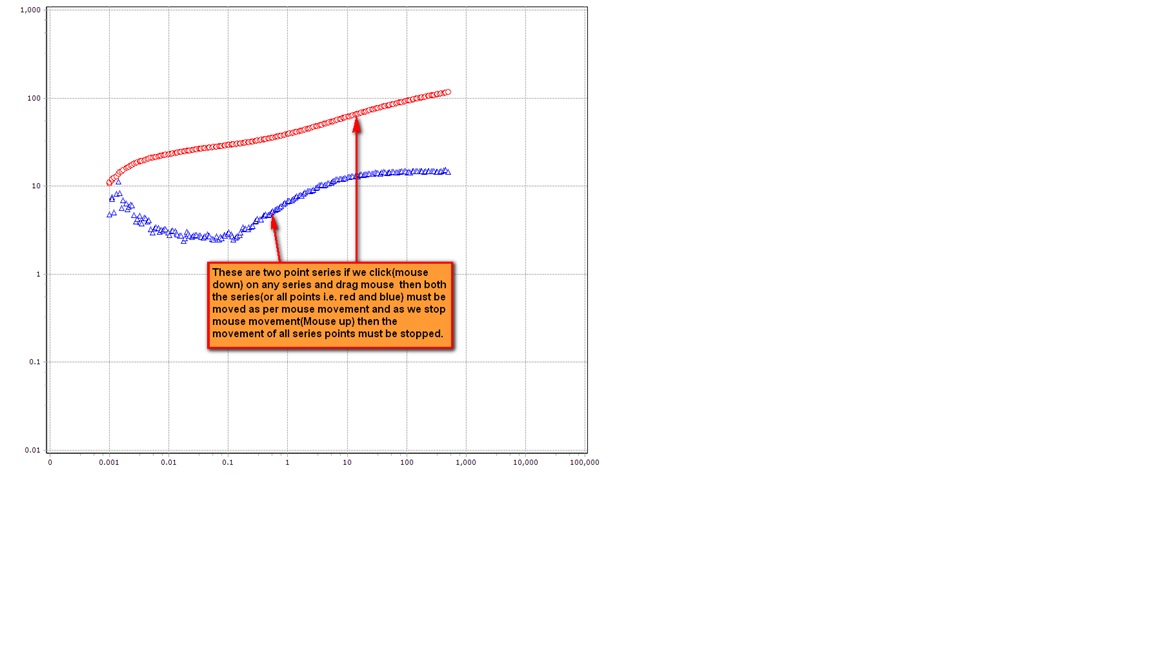

Your reply is helpful for us but not exactly resolving our issue. Now we are attaching a vedio showing the need.
In this when we click and move the whole curve is moved and when we mouse up then the curve or data plotted as per axis values.One important thing is that when we move curve then the shape of curve does not changed.

Hi Steema Support,
Many thanks for your reply and given examples but it is not same thing for what we are looking. So please provide any alternate solution for the same.
Regarding Link 1:
In given link http://www.teechart.net/support/viewtopic.php?t=4833.
First thing is that in this example movement of line series shown but when we visible line series pointer then on line movement line pointer not visible.
Second thing is that we want to use points series in Logarithmic axis as shown in video(that we previously send).

Can you please tell me if you've ever seen such an error message? This error message leads me to suspect that an entirely different way of working is going to be necessary here.
Logarithmic axes are especially problematic to program, as you have experienced yourself. As you can see, even using the standard TeeChart scroll functionality (right mouse button) does not work as it works in non-logarithmic axes. I am not particularly optimistic that we the present TeeChart code we are going to be able to reproduce the functionality you are looking for.

- Guru
- Posts: 1603
Re: Problem in Moving point series in logarithmic AXIS
I'm afraid to say that being able to drag an entire series across a chart when the chart axes are logarithmic without the series suffering any deformation to its shape is something which is not currently possible in the TChart code. Getting such functionality to work is something that would require a lot of work on our part, if indeed it is possible.amol wrote: Many thanks for your reply as you told that logarithimic axes are problematic, i agree with your point. But please do needfull or provide any alternative solution for the same. Because we have to achieve this functionality in my application by any mean.
