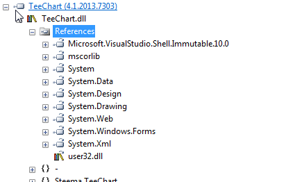

Upon looking at the library with .NET Reflector, I noticed that there is a reference to Microsoft.VisualStudio.Shell.Immutable.10.0. Why is it now a required dependency when earlier version did not appear to need tis reference? I don't think I should have to ship this assembly in order to get my application to run on a client's machine.

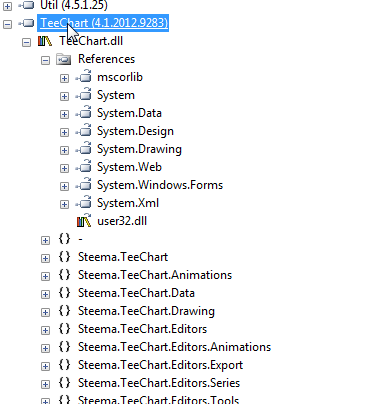

To clarify my point, I'm attaching to screenshots of different versions of TeeChart, 4.1.2012.9283 and 4.1.2013.7303, to highlight the different dependencies. The 2012 version does not have a dependency on Microsoft.VisualStudio.Shell.Immutable, which I am not shipping and thus causing the error on my client's machines. Can I compile the newer version myself without the dependency, and why is it needed?
