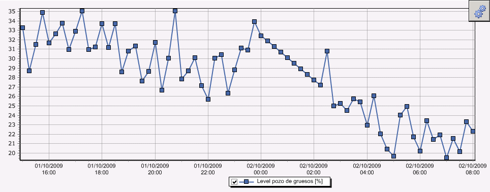

Is it possible to have always visible in the x-axis the initial and final date?
By example in the attached screenshot we can see fist visible date in the axis is "01/01/2009 16:00" but, the chart starts but I would like to see in the x- axis "01/01/2009 13:00" just in the begininng of the chart. Is it possible?

Now it show the time of the first inserted point, but if I don't have automatic scale in x-axis it doen't show the first value of the axis in the 0/0 coordinate...

It is not exatly what I want because the first date would be the first point, and I would like to see the minimum of the x-axis scale. I think I could change the code to do it manually, but then I would lose the automatic way of teechart to write dates... and it is very usefull because in the manual way the dates sometimes are one over other...
So it there isn't any automatic way, I think it is better to forget it, it's not a very important requeriment.
