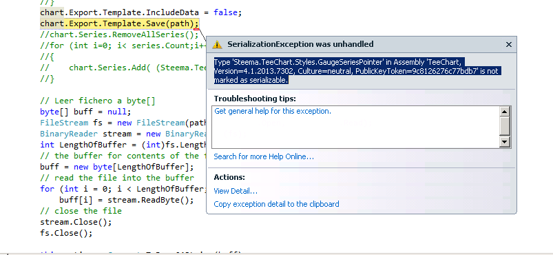

Post by acastro » Fri Nov 08, 2013 9:21 am
I have recently upgrade Teechart from a two years old version, and I have this error, in a code which runs before the upgrade.

It runs, but try this example project
http://193.145.251.126/pnp/files/Xmutyz ... chart2.zip
Push button1, and then button2. I get the error in button 2.

Thanks for extra information. I can reproduce this problem, I have added it in bug list report with number [id90]. We will try to fix it to upcoming versions of TeeChartfor.Net. Remember you can follow the status of the bug in this link.
On the other hand, could you tell us in which version it works fine for you?
