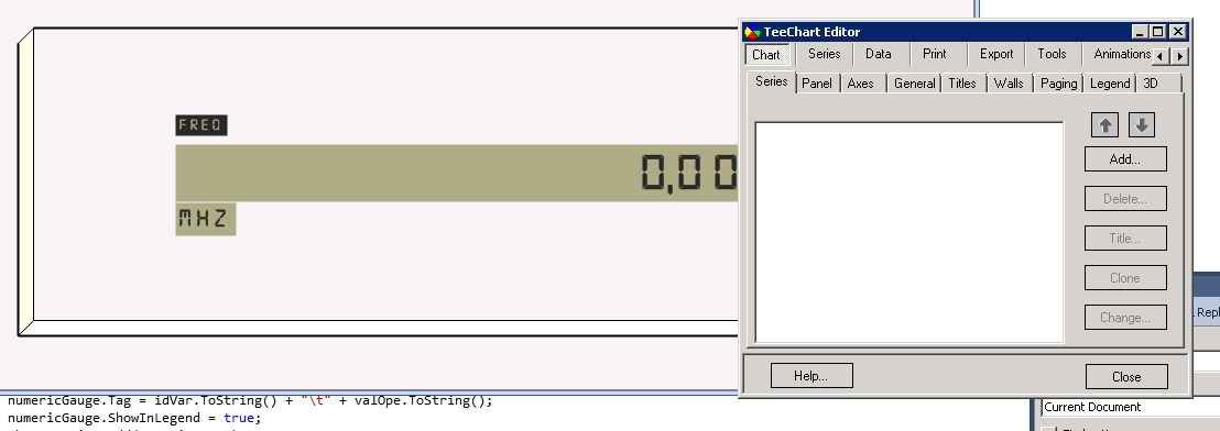

When I add a serie to a numeric gauge some markers are automatically added.
But when I remove the serie the markers are not deleted automatically, is this behaviour right?

Re: Numeric gauge and markers
Please download the example project
http://193.145.251.126/pnp/files/qUdMHY ... chart2.zip
Click en button1 and then in button2, you will see markers are not deleted and they can be seen in "Tools" sheet.
Yes but that removes all series, and I usually have several series and I only want to delete one so I have to use it...
Hello wakeup,
Sorry for the delay. I have tested your code and you are right. I have added your problem in bug list number [Id100]. We will try to fix it to upcoming versions of TeeChartFor.net. You can check the bug status in next link. Remember, now in new bug tracker system, you can add the problems you consider as a bug, directly.
On the other hand, you can use next workaround to remove the NumericSeries:
Steema.TeeChart.Styles.NumericGauge num = new Steema.TeeChart.Styles.NumericGauge();
tChart1.Series.Add(num);
Steema.TeeChart.Styles.NumericGauge s = (Steema.TeeChart.Styles.NumericGauge)tChart1[0];
s.Markers.Clear();
tChart1.Series.RemoveAt(0); // tChart1.Series.Remove(s);
tChart1.Refresh();
