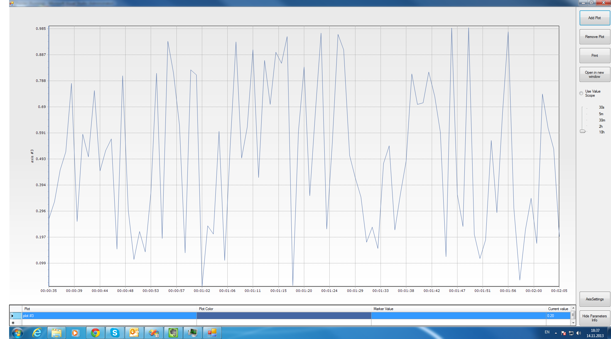

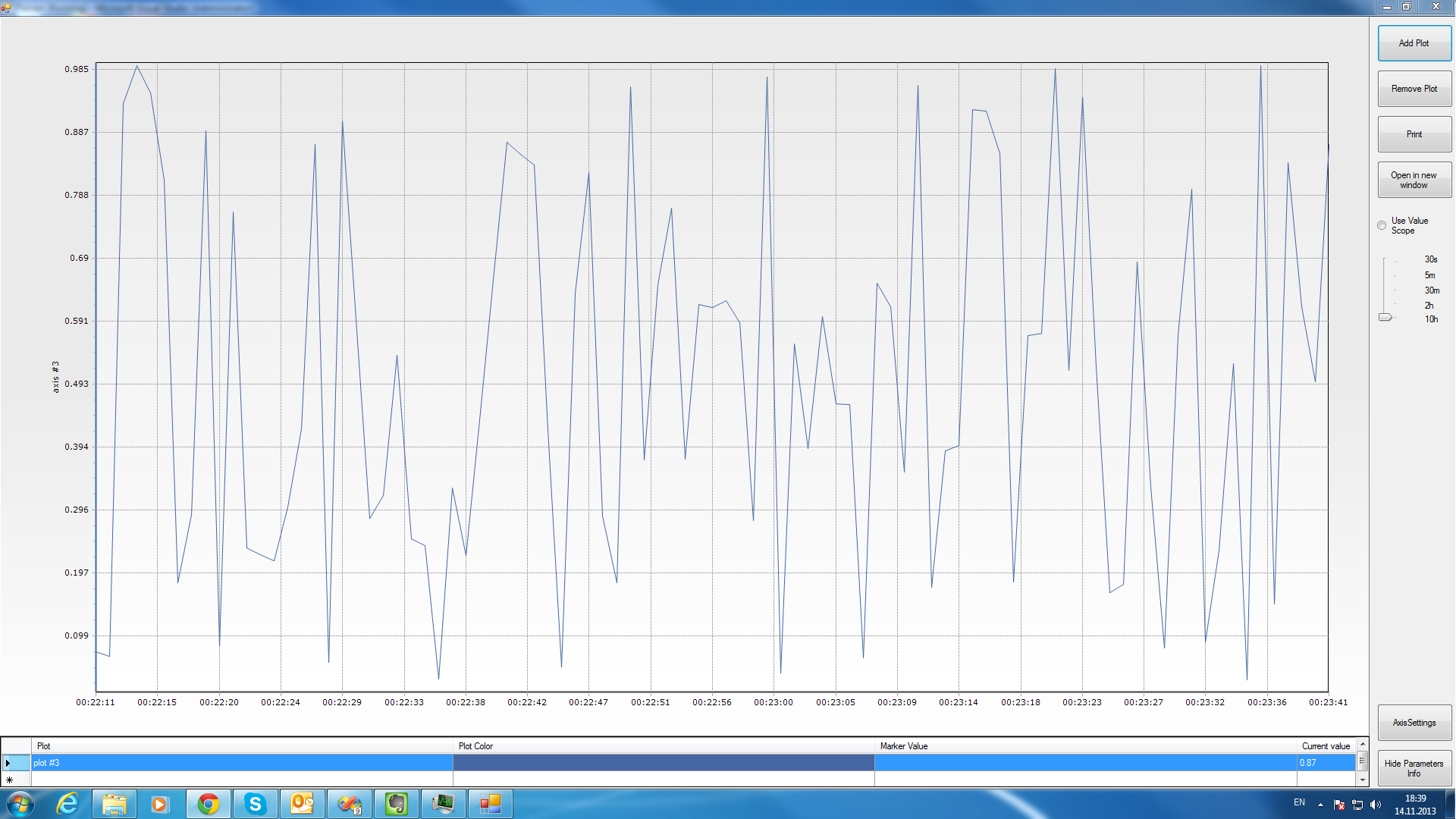

No, i mean that labels must have constant position on the canvas, but the labels value vary constantle.
On this two pics You can see What i want to have.
As you can see the values are different, but the labels positions are same places, and the range of bottom axis is also constant. Also you can find that it's a realtime chart. So everytime, when series updates, i use to recalculate increment ofset wit Scroll axis function. That's no correct, because it doesn't work properly if Canvas Size() changes. So i'm looking the different way to solve this problem. Any advices?
P.S. Text length is constatnt.
