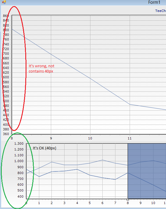

After add ScroolPager tool the panel margins in pixels doesn't work.
See attachment.

If you wan change the Margins of Parent Chart after add ScrollPager Tool you must disable previously the CustomChartRect as do in next line:
tChart1.Chart.CustomChartRect = false;
After you have done it, you can adjust the margins as you want. Could you tell us if previous code works for you?

Hi Sandra, thanks for your response. This code works perfectly.
