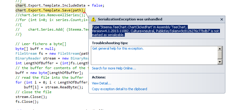

Post by acastro » Tue Dec 17, 2013 3:11 pm
I have this error trying to save. I think it is due to the a selector tool. This code run with a Teechart version of 2001, but know it fails with the updated version.

Post by Christopher » Tue Dec 17, 2013 4:20 pm
I have entered this defect into our public bug tracker here and have already found a fix to it. This fix will be available in the next maintenance release, due out in the first month of next year.
