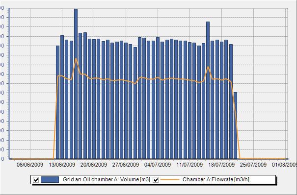

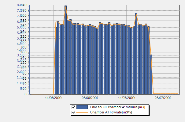

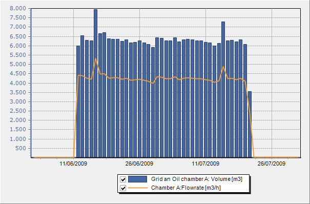

      tChart1.Import.Template.Load(@"C:\tmp\labels.ten");  //labels1.png
      //tChart1.Panel.MarginLeft = 10; //uncomment for labels2.png
      //tChart1[1].CustomVertAxis = null; //uncomment for labels3.png
and here are the three resulting images:
I'm not sure what the problem is with any of these images - could you please explain it to me?

I want to have the Label2.png result, but without changing the MarginLeft to 10. I mean, If I put the axis "Left" it is shown correctly with MarginLeft =3. Why with axis "Custom 0" it now shown in the same way with MarginLeft = 3?
