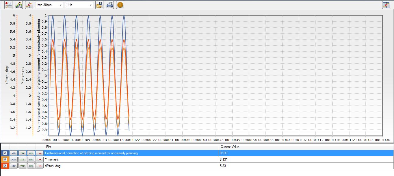

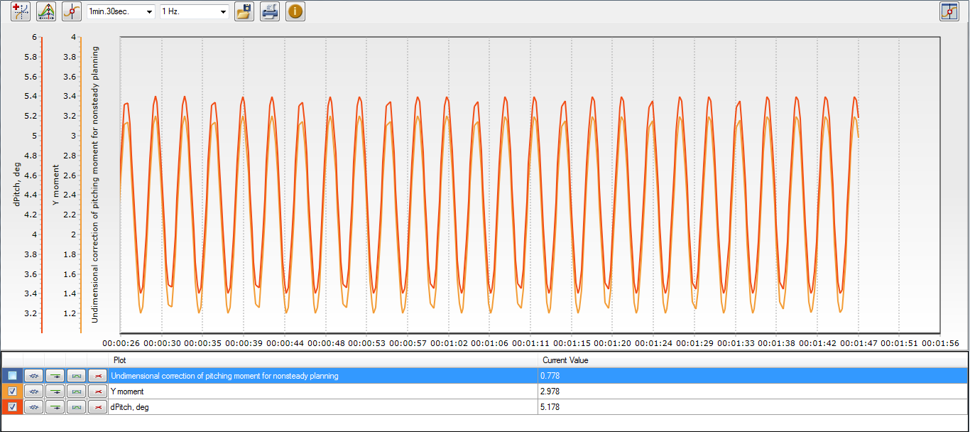

Hi Christopher, unfrtunately that doesn't helps. let me try to explain you on example.In attachement there are two pics, on the "active axis.png" you can see the situation than all axes are active( active means that line is visible ). In this case axis has the same color as line and have labels and marks on it ( so, it's scaled ). On the second pic, called "inactive axis.png" you can see the situation i want to modify, the first plot is invisible now( you can see it's uncheked ), so the first axis is inactive, that means that should become gray with saving all the marks and labels on it. As you can see it's gray, but, there are no labels and ticks on it. So what should i do to set it back?

Re: Drawing labels and ticks on the axis in case of series lack
Post by Christopher » Thu Feb 27, 2014 8:56 am
Petr wrote:Hi Christopher, unfrtunately that doesn't helps. let me try to explain you on example.In attachement there are two pics, on the "active axis.png" you can see the situation than all axes are active( active means that line is visible ). In this case axis has the same color as line and have labels and marks on it ( so, it's scaled ). On the second pic, called "inactive axis.png" you can see the situation i want to modify, the first plot is invisible now( you can see it's uncheked ), so the first axis is inactive, that means that should become gray with saving all the marks and labels on it. As you can see it's gray, but, there are no labels and ticks on it. So what should i do to set it back?
I think I understand your situation. What I don't understand is why you cannot set the Series.Transparency property to 100 instead of setting the Series.Active/Visible property to false when you uncheck the checkbox. The issue is here that axis labels and ticks will only be drawn if a series is associated to the axis, and setting the Series.Active/Visible property to false disassociates the series from the axis. The only way, therefore, to have the series invisible but the axis labels and ticks visible is to keep the series associated to the axis, that is, keep the Series.Active/Visible property set to true, but to set the Series.Transparency to 100.

Post by Petr » Thu Feb 27, 2014 10:43 am
