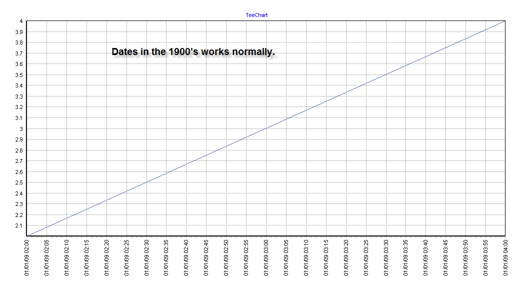

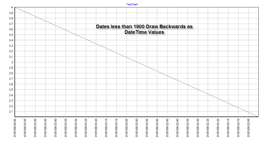

Years in the 1800's dates print backwards.
I sell forecasts online and use this chart -- everything's been fine.
I created a forecast and dates dip into the 1800's and everything printed backwards on the chart.

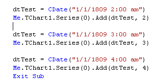

Here's test code to show the problem:
vb.net
Dim dtTest as DateTime
dtTest = CDate("1/1/1809 2:00 am")
Me.TChart1.Series(0).Add(dtTest, 2)
dtTest = CDate("1/1/1809 3:00 am")
Me.TChart1.Series(0).Add(dtTest, 3)
dtTest = CDate("1/1/1809 4:00 am")
Me.TChart1.Series(0).Add(dtTest, 4)
Chart is defined with bottom axis as datetime and so is fastline series.
If there's a limitation on printing dates in 1800's I didn't see it in the documentation and this control would then be worthless to me.
I"m hoping it's some trick I didn't know or something simple.
thanks in advance anyone who can help me get past this challenge.
Joseph
Code to replicate.
Same chart with years changed to 1909 or 2009 works as expected -- not backwards.

jzarech wrote:If there's a limitation on printing dates in 1800's I didn't see it in the documentation and this control would then be worthless to me.
The explanation for this behaviour is as follows. CDate("1/1/1809 2:00 am") returns a negative double value, as can be seen in this simple test:
  Private Sub Button1_Click(sender As Object, e As EventArgs) Handles Button1.Click
    Dim dtTest As DateTime
    MessageBox.Show(dtTest.ToOADate().ToString())
  End Sub
So when running code such as the following:
  Private Sub InitializeChart()
    Dim series As Line
    series = New Line(tChart1.Chart)
    series.Add(dtTest, 2)
    series.Add(dtTest, 3)
    series.Add(dtTest, 4)
    series.XValues.DateTime = True
    tChart1.Axes.Bottom.Labels.Angle = 90
    tChart1.Axes.Bottom.Labels.DateTimeFormat = "dd/MM/yyyy hh:mm:ss"
  End Sub
where each consecutive XValue is a larger negative number, then the series plots 'correctly' with each larger negative number further to the left. There is a simple workaround to this that will need a little explanation. The zero point at which DateTime values cease to be negative can be seen using this code:
    dtTest = DateTime.FromOADate(0.0)
    MessageBox.Show(dtTest.ToShortDateString() + " " + dtTest.ToShortTimeString())
  End Sub
any DateTime value greater than "31/12/1899 0:00" will be positive and so more recent DateTime values than this will be plotted as larger positive numbers, that is to say, to the right of the previous ones. So, for plots involving DateTime values smaller than this we can use:
tChart1.Axes.Bottom.Inverted = True
to invert the bottom axis and have larger negative values plot to the right of smaller negative values as if they were positive values, e.g.
