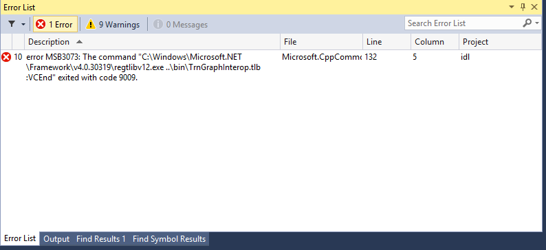

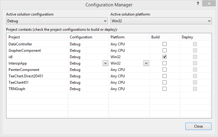

Petr wrote:here you can find my project with test application. Here's the build order:
I think I must be doing something wrong. I start with this:
but when I build I get this:

Hi Chrostopher! Probably you have a different path to regtlibv12.exe, in this case you can try to change the path in Command line in Post-Build events property page of idl project. On the othe hand i can say you that you don't need to complie idl and InteropApp, because they are already compiled to bin folder, so you can find them there. So, i hope, with managed projects you won't have any problems.

I'm very sorry, but I'm afraid I don't understand those instructions. My questions are:
1) how do I set the buildorder?
2) how to I attach to the Interop? (and what do I attach to it?)

The build order is:
1. DataController
2. PainterComponent
3. GrapherComponent
4. TRNGraph
To attach to InteropApp you shoul start it from bin folder and chose Tools->Attach to Process from Visual Studio main menu, chose InteropApp from the list and click Attach button.
