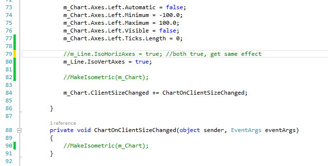

As an alternative, you can use one of the Series.IsoHorizAxes or Series.IsoVertAxes, e.g.
if you use both at the same time you will get the effect that your code gets - this effect is unavoidable, I'm afraid, the isoaxes can only be for horizontal or vertical directions, not both.

I've been able to reproduce this here and have added it to our bug database with id=721. I've spent some time trying to find a workaround to this problem, but unfortunately without success.

No, at the moment these properties only belong to the Series class, enabling some series to render "Iso" while others render normally.
Raavi wrote:Right now, I add series with 'IsoHorizAxes = true' to a Chart and set Chart.Dock to Dockfill.
This way does not set the IsoHorizAxes until I change the size of the Chart or Pan the Chart.
This problem is doubtless related to the id=721 bug I mentioned in my last post. Again, I'm afraid I haven't been able to find a workaround to this issue.
