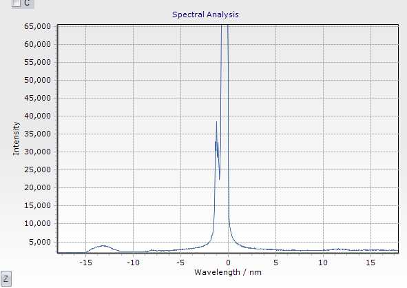

Please see the chart I've attached. What I want is to really select a rectangle from X coords -15 to +15 and height 65,000 and then display. Only not drawing a rectangle but using code to replicate this.

Thanks but thats not really helping. I dont think Ive explained it very well
Ive just tried the following code;
Rectangle r = new Rectangle(-15, 65000, 30, 65000);
spectrumChart.Zoom.ZoomRect(r);
However this doesn't work at all. I see nothing and it seems to have zoomed into a small area in my chart.
Am I on the right track?

Yes and noDave wrote:Hi Christopher
Possibly the easiest way to do this would be to use the Axis.SetMinMax method, e.g.
tChart1.Axes.Bottom.SetMinMax(-15, 15);
