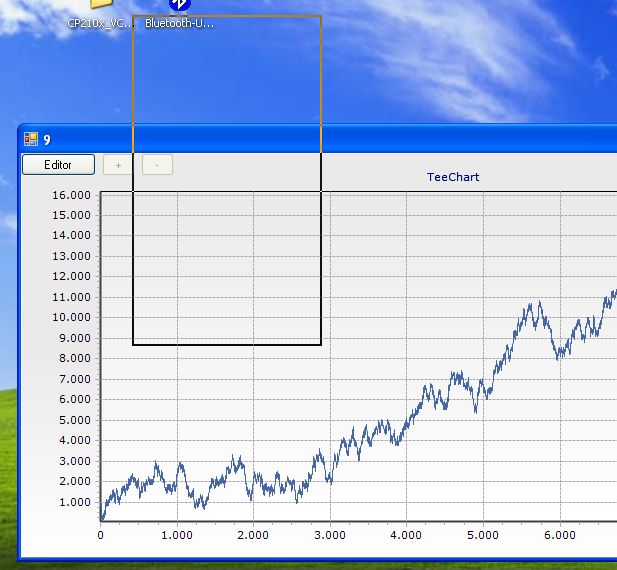

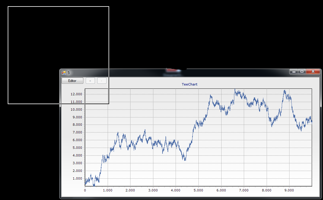

I think there is a problem in the Zooming functions ... Just use the attached sample projekt and run it. Open the Editor and go to the General/Zoom tab.
Set the Direction to Horizontal and press close to end the editor.
Now just zoom within the chart. I got this rectangles on different computers:
Problem on Windows XP 32 Bit
This is on windows XP (32 Bit)
Problem on Win7 64 Bit
This is on my developement system with Win7 64Bit.
And I asked one of our users to test it, too. He has the same behaviour on a XP 32Bit system.
Can you confirm this issue and tell me a quick workaround or a new Tchart.dll with a fix?
We want to bring out our new software, soon. But this issue is a real blocking point for us. :?
Best regards
Dominik

Hello Dominik,
moelski.net wrote:Oh I forgot this:
IDE : VS 2012
Language : C#
Yes, I've been able to reproduce this issue here and have added it to our bug database with ID=760. As you can read there, there is a temporary workaround to this issue:
          this.editor1.CloseEditor += editor1_CloseEditor;
          this.editor1.ShowModal();
        void editor1_CloseEditor(object sender, EventArgs e)
          tChart1.Zoom.Pen.Visible = false;
You will also be able to see that this issue is now fixed and will be available in the next maintenance release, due out within the next two working days.

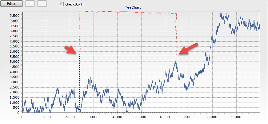

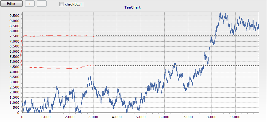

I think there is another issue on this zoom topic. I use this code to detect STRG and SHIFT key to set vertical or horizontal zooming:
        private void tChart1_MouseDown(object sender, MouseEventArgs e)
            var strgPressed = ModifierKeys == Keys.Control;
            var shiftPressed = ModifierKeys == Keys.Shift;
            var bothPressed = ModifierKeys == (Keys.Shift | Keys.Control);
            if (e.Button == MouseButtons.Left)
                if (!strgPressed & !shiftPressed) { this.tChart1.Zoom.Direction = ZoomDirections.Both; }
                if (strgPressed) { this.tChart1.Zoom.Direction = ZoomDirections.Horizontal; }
                if (shiftPressed) { this.tChart1.Zoom.Direction = ZoomDirections.Vertical; }
But if I run this code the zoom rectangle is not drawn at the correct position:
Horizontal Error
Horizontal Error.png (52.97 KiB) Viewed 18342 times
Vertical Error
Vertical Error.png (48.5 KiB) Viewed 18335 times
I have placed some red marks. That would be what I would expect from the rectangle to be drawn.
You can test this with my sample application above.
Hope this can be fixed, too.

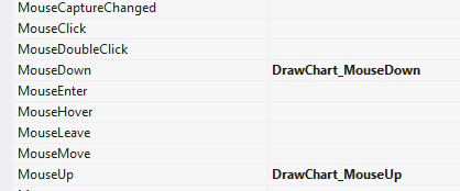

Oh and one additional thing if missing (which is important for zooming, too). The MouseWheel event is not visible in the IDE:
But I think this is not a big deal ... :wink:

Post by Christopher » Tue May 06, 2014 11:15 am
moelski.net wrote:Hope this can be fixed, too.
Not so much fixed, but a technique that can be deployed:
      int x = e.X;
      int y = e.Y;
        if (strgPressed)
          y = rect.Top;
          tChart1.Zoom.Activate(x, y);
        if (shiftPressed)
          x = rect.Left;
This is happening because the TeeChart code in the OnMouseDown event is being called before your code in this tChart1_MouseDown event. This is inevitable. To correct for this we can copy a little of the necessary functionality, which includes the call to Zoom.Activate.

moelski.net wrote:But I think this is not a big deal ... :wink:
This is strange, but as you can see from the documentation for the System.Windows.Forms.Control MouseWheel event, the BrowsableAttribute is set to false. I'm not sure why.
