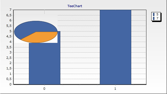

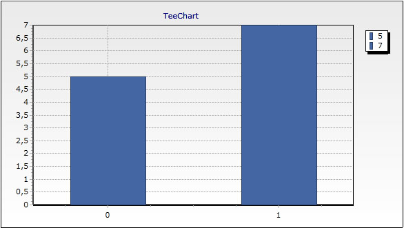

But if I try to export this TChart to XAML:
MyTChart.Export.Image.XAML.Save(saveDialog.FileName);
The result won't contain subchart data:
Re: SubChart. Exporting to XAML
Post by Christopher » Thu May 15, 2014 2:36 pm
I have been able to reproduce this defect and it has already been fixed.
As a workaround, you can export your chart to XAML with a SubChartTool using TeeChart.dll (WinForm TeeChart) and manually edit the XAML to remove the erroneously nested <Canvas> object.

Now I can see a subchart in the exported xaml, but it has wrong background. I set transparent color to the subchart panel's background (subChart.Panel.Color = Colors.Transparent;) but exported xaml contains wrong rectangle:
<Rectangle
 Canvas.Left="50" Canvas.Top="50" Width="151" Height="101">
 <Rectangle.Fill>
   <LinearGradientBrush StartPoint="0.5,0" EndPoint="0.5,1">
    <GradientStop Offset="0" Color="#FFEAEAEA"/>
    <GradientStop Offset="1" Color="#FFFFFFFF"/>
  </LinearGradientBrush>
 </Rectangle.Fill>
</Rectangle>
If I set StartColor and EndColor properties of subChart.Panel.Gradient to transparent, then the exported xaml will be ok. But it would be great if the source and exported TChart appear the same.
And finally, it seems that non-transparent value of subChart.Panel.Color property doesn't work in WPF TChart. If I set it to red, for example, then the subchart's background will be gradient of gray and white.

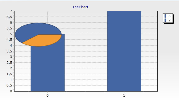

The problem is produced because you need set the panel gradient to false. The Subchart is exported with a transparent or coloured background without problems here, using the lines below.
subChart.Panel.Gradient.Visible = false;
//subChart.Panel.Color = Colors.Red;
Hoping it will helps.

It works. But the problem is that if I don't hide gradient and set subChart.Panel.Color to transparent the picture on the screen and in the exported xaml are not the same.
It's not normal for me.
