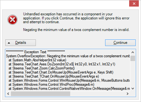

Attached the exception window when,
I try to re-size the window to absolute minimum and bringing the size back to normal and then pressing left button mouse down to zoom it back an exception is thrown.
Chart contains a line with IsoHorizAxes =true and
tChart1.BeforeDrawSeries += tChart1_BeforeDrawSeries;
void tChart1_BeforeDrawSeries(object sender, Graphics3D g)
tChart1.Axes.Bottom.AdjustMaxMin();

Hello Raavi,
Raavi wrote:I try to re-size the window to absolute minimum and bringing the size back to normal and then pressing left button mouse down to zoom it back an exception is thrown.
Try:
      tChart1.Resize += tChart1_Resize;
    void tChart1_Resize(object sender, EventArgs e)
      if (rect.Height <= 5 || rect.Width <= 5)
        tChart1[0].IsoHorizAxes = false;
      else if (rect.Height >= 5 && rect.Width >= 5)
        tChart1[0].IsoHorizAxes = true;
