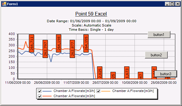

Post by acastro » Tue May 27, 2014 6:54 am
Please find the example application to reproduce. If you press button3, to load the "Chart1.ten" file, you can see that some of the marks on the right are not well positionated although they have very similar values.
http://193.145.251.126/pnp/files/OLxLvb ... tMarks.zip
Re: Marks now well positionated
Post by Christopher » Tue May 27, 2014 9:54 am
wakeup wrote:Please find the example application to reproduce. If you press button3, to load the "Chart1.ten" file, you can see that some of the marks on the right are not well positionated although they have very similar values.
Here you could try setting the Marks.AutoPostion property to false, e.g.
        private void button3_Click(object sender, EventArgs e)
          tChart1.Import.Template.Load(@"D:\Downloads\TestMarks\Chart1.ten");// @"C:\example.ten");
          for (int i = 0; i < tChart1.Series.Count; i++)
            tChart1[i].Marks.Clip = false;
            tChart1[i].Marks.AutoPosition = false;
