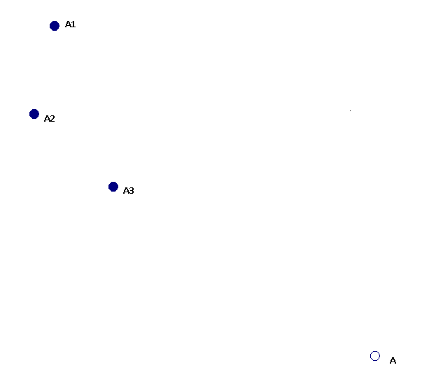

Hi ,
I need to show the title of the point and shape of the point same as attached image. How can i implement this.

Thanks for the quick response but I need point title same as Image. Means right of the point.

Post by amol » Wed Jun 04, 2014 10:39 am
and the point shape should be same as image

Post by Christopher » Thu Jun 05, 2014 10:52 am
amol wrote: Thanks for the quick response but I need point title same as Image. Means right of the point.
amol wrote:and the point shape should be same as image
You could try something like this:
    List<SeriesMarks> customMarks = new List<SeriesMarks>();
      Points point = new Points(tChart1.Chart);
      Random rnd = new Random();
      for (int i = 0; i < 10; i++)
        point.Add(i, rnd.Next(10, 100), Convert.ToChar(65 + i) + i.ToString());
        customMarks.Add(new SeriesMarks(point));
      point.Pointer.Style = PointerStyles.Circle;
      tChart1.AfterDraw +=tChart1_AfterDraw;
    void tChart1_AfterDraw(object sender, Graphics3D g)
      for (int i = 0; i < customMarks.Count; i++)
        customMarks[i].Text = tChart1[0][i].Label;
        customMarks[i].Transparent = true;
        customMarks[i].Paint(g, Utils.FromLTRB(tChart1[0].CalcXPos(i), tChart1[0].CalcYPos(i), tChart1[0].CalcXPos(i) + 50, tChart1[0].CalcYPos(i) + 50));
