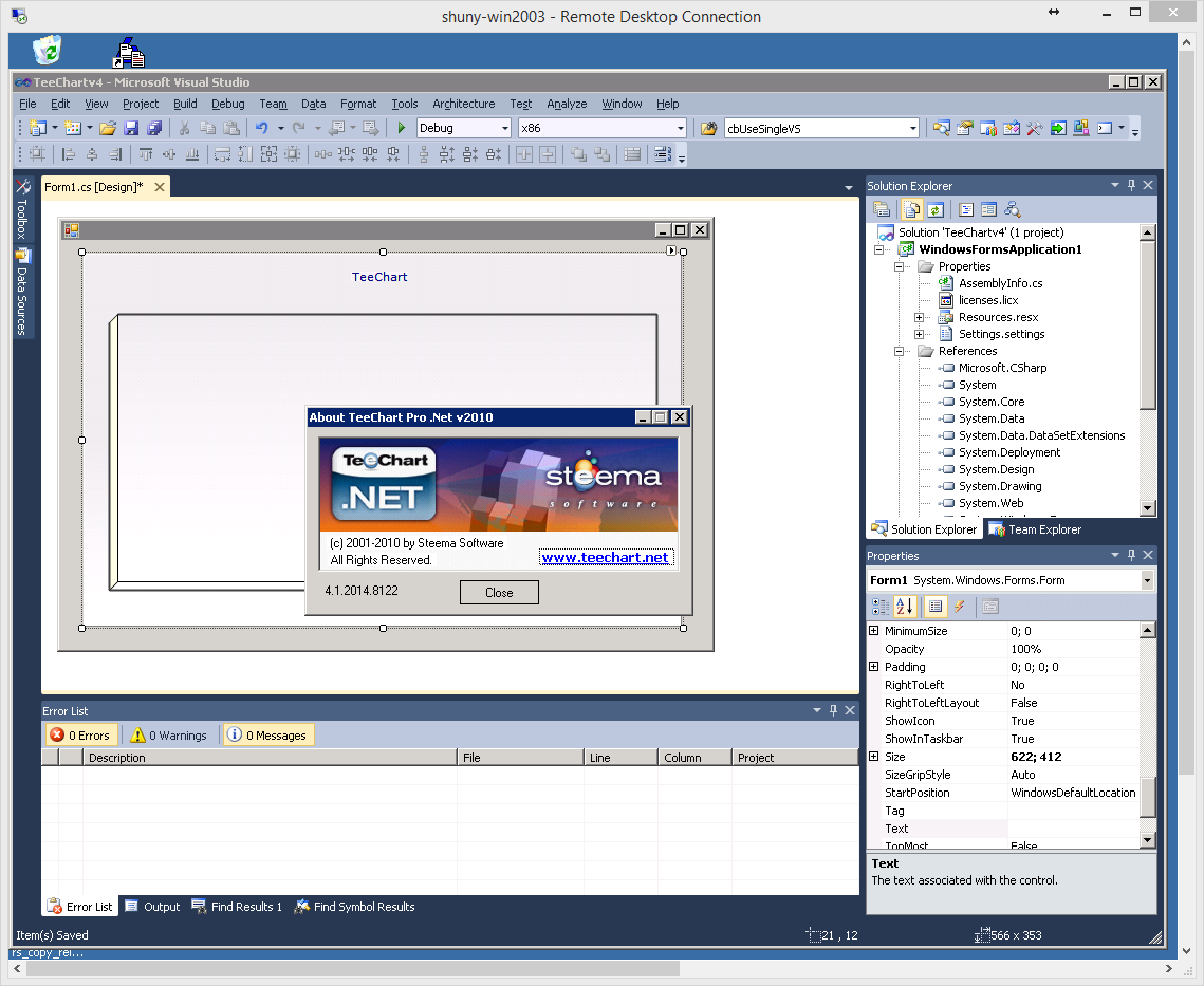

This seems to work fine here, as can be seen in the following image:

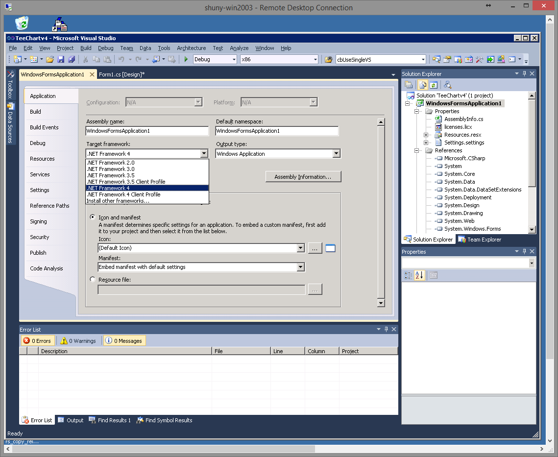

Are you sure you have the "Target Framework" of the project set to ".NET Framework 4" and not ".NET Framework 4 Client Profile"? e.g.

Hello Christopher :
Yes, I am using the .Net Framework 4.
Not sure if it relates with the configuration with my project and vs.net.
Ying-Hui

YingHui wrote: Yes, I am using the .Net Framework 4.
I'm not sure either. As you can see, I'm using the same TeeChart.dll as you are in the same version of Visual Studio and with the same version of the .NET Framework.
