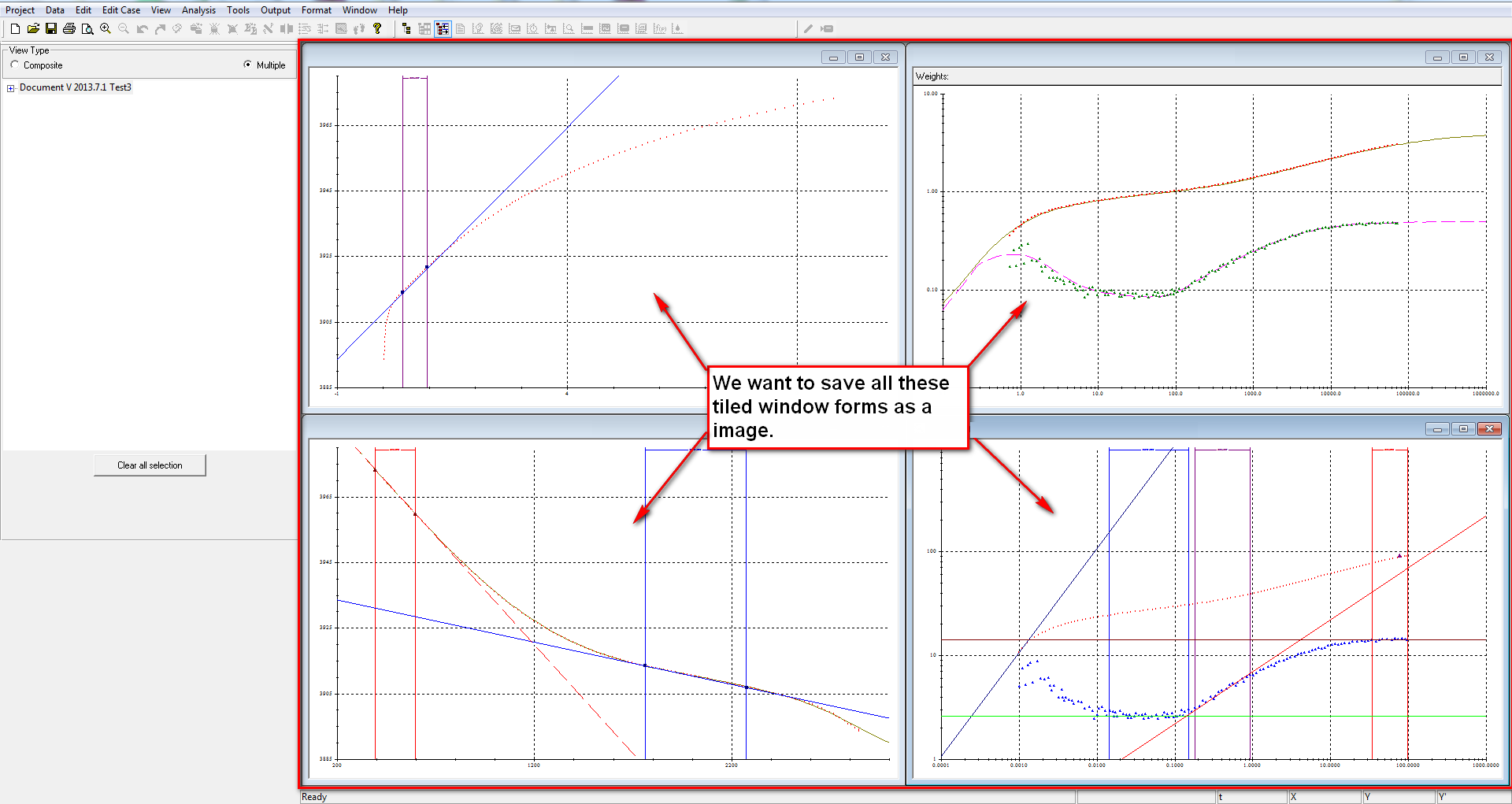

We want to save the single image of Multiple opened charts in different tiled windows as shown in image. as shown in attached image
Save Image of Multiple Chart
save as image.png (135.54 KiB) Viewed 16089 times
Please provide any solution asap.

Hello!
This isn't really a TeeChart issue per se, as TeeChart is perfectly capable of exporting itself to an image.
If you want to combine two (or more) images to one image, you can create a new bitmap then paint each image onto it. First create a bitmap at runtime, then create the graphics from the image and then use this graphics to draw your images to it.
