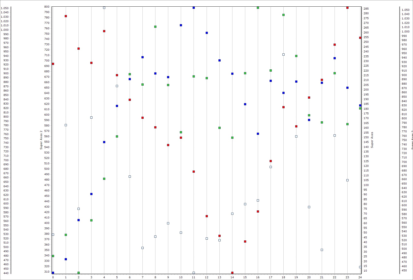

Friis
Posts: 26
Joined: Thu Oct 16, 2014 12:00 am
Re: Problems with multi Axes
Post by Friis » Thu Nov 06, 2014 7:13 am
I have added two images illustrating the problems with the axes.
Kind regards - HH Friis

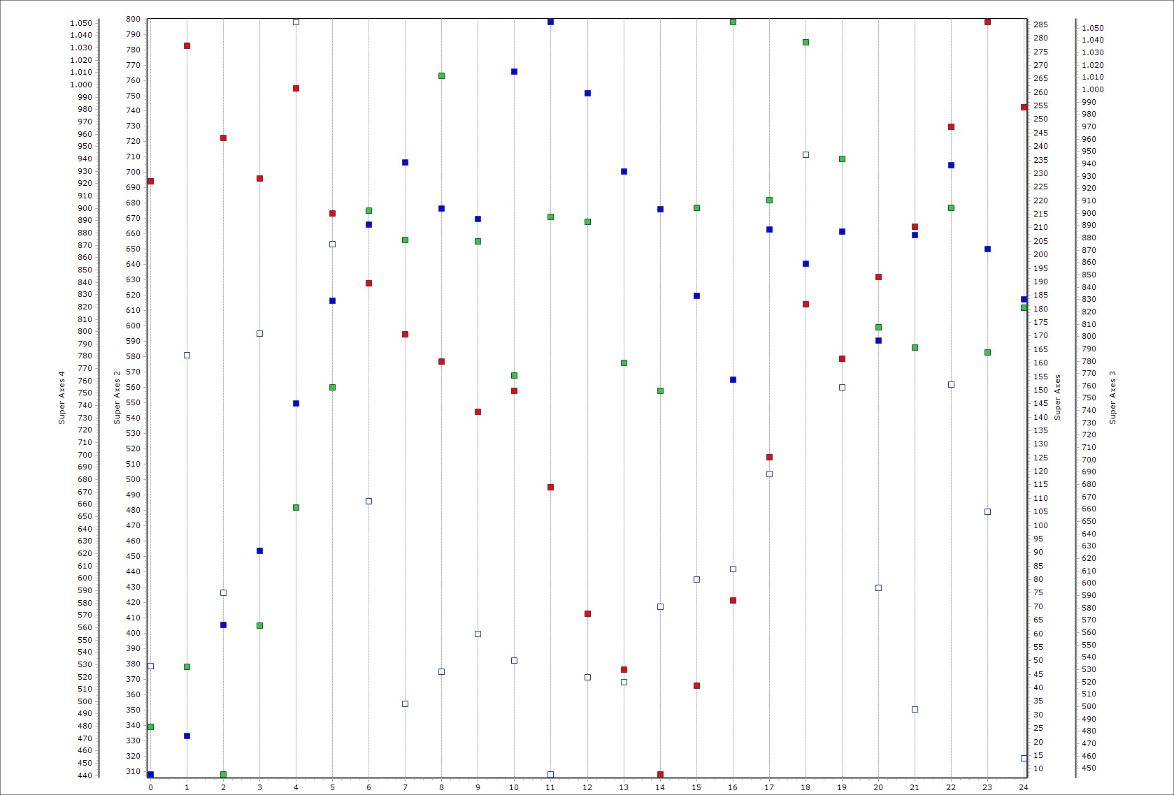

Friis
Posts: 26
Post by Friis » Thu Nov 06, 2014 12:15 pm
Hi Christopher,
I'm sorry but it still doesn't work
1) Try to start with all 4 series active = all 4 chckboxes checked.
2) Then uncheck first checkbox4, then uncheck checkbox3, then uncheck checkbox2 and finally uncheck checkbox1 - (series4.Active = false; then series3.Active = false; then series2.active=false, ect...)
The order in which you unchck is very important!!
3) Activate series 3 / check ckeckbox3
3) as you can see the axes positioning is still incorrect...??
Post by Christopher » Thu Nov 06, 2014 2:58 pm
To resolve the issue you speak of, all that is necessary is the following change:
    private void checkBox3_CheckedChanged(object sender, EventArgs e)
      tChart1[2].Active = checkBox3.Checked;
      tChart1.Axes.Custom[2].Visible = tChart1[2].Active;
      tChart1.Draw(); //<- here
      PlaceAxes(2, 0, 0, 0, 0); //<- here
As I say, I think your code needs a little more work before being robust.

I have tried to change it in accordance with your instructions, see code below
1) Start with all series active=true
2) then try to inactive series 3 and re-activate the series (uncheck checkbox3, then recheck checkbox 3)
That makes the axes overlap...??
Post by Christopher » Thu Nov 06, 2014 3:24 pm
Friis wrote:Hi
Try:
    private void PlaceAxes(int NextXLeft, int NextXRight, int MargLeft, int MargRight)
      const int extraPos = 50;
      const int extraMargin = 105;
      //Variable
      int MaxLabelsWidth;
      int lenghtTicks;
      int extraSpaceBetweenTitleAndLabels;
      for (int nSeries = 0; nSeries < tChart1.Series.Count; nSeries++)
        if (tChart1[nSeries].Active)
          MaxLabelsWidth = tChart1.Axes.Custom[nSeries].MaxLabelsWidth();
          lenghtTicks = tChart1.Axes.Custom[nSeries].Ticks.Length;
          extraSpaceBetweenTitleAndLabels = 0; //(tChart1.Axes.Custom[nSeries].Title.Width);//<- here
          //extraSpaceBetweenTitleAndLabels = (tChart1.Axes.Custom[nSeries].Title.Width);//- tChart1.Axes.Custom[nSeries].MaxLabelsWidth());
          if (tChart1.Axes.Custom[nSeries].OtherSide)
            tChart1.Axes.Custom[nSeries].RelativePosition = NextXRight;
            NextXRight = NextXRight - (MaxLabelsWidth + lenghtTicks + extraSpaceBetweenTitleAndLabels + extraPos);
            MargRight = MargRight + extraMargin;
            tChart1.Axes.Custom[nSeries].RelativePosition = NextXLeft;
            NextXLeft = NextXLeft - (MaxLabelsWidth + lenghtTicks + extraSpaceBetweenTitleAndLabels + extraPos);
            MargLeft = MargLeft + extraMargin;
          tChart1.Panel.MarginLeft = MargLeft;
          tChart1.Panel.MarginRight = MargRight;
Friis
Post by Friis » Fri Nov 07, 2014 7:02 am
Thank you for helping me ;-)
It works really well now ;-)
